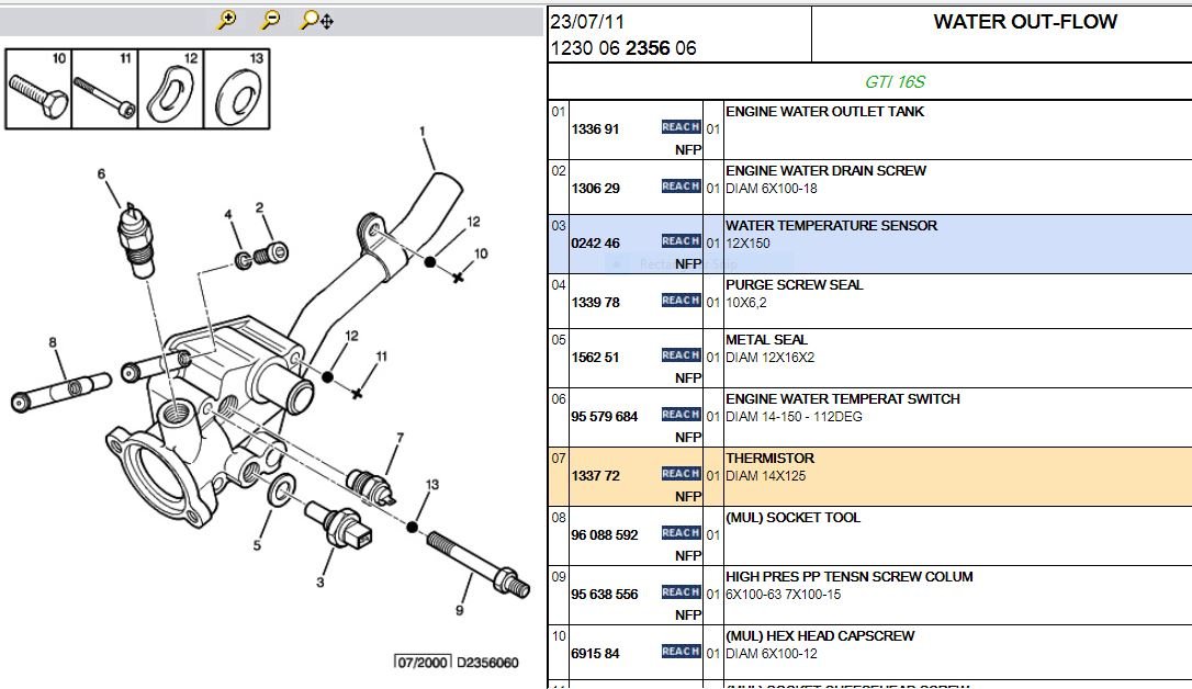

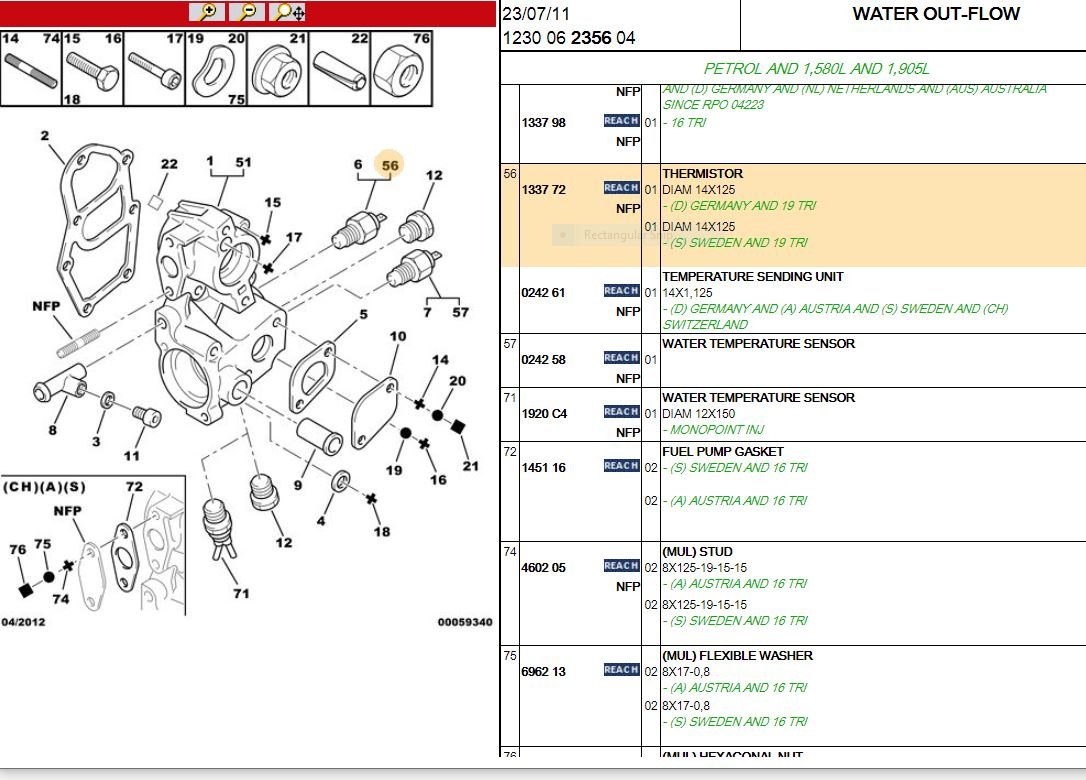

Have come to the same conclusion - a 1337 72.
NFP, but lots of equivalents available (eg on Mister Auto). The QH equivalent there (QH XTT28) helpfully says "With water temperature gauge". Febi 30767 is another common one.
Trawling through the Servicebox parts pages, seems to confirm that the temperature gauges were only fitted to BX for the 19GTi, which also got a 112°C temp (warning) switch, and a 12mm-thread 2-pin temp sensor (presumably for the Inj ECU). A good few cars also made use of the 1337 72 thermistor. Fortunately, lots of 14mm threaded holes on most of our water outlets, with not all of them always used.

While looking through pages at gauge sensor info (and settling on the 1337 72, which is now ordered for the grand sum of €9), I was trying to find an electrical wiring diagram for the 19GTi which actually covered instrumentation.
