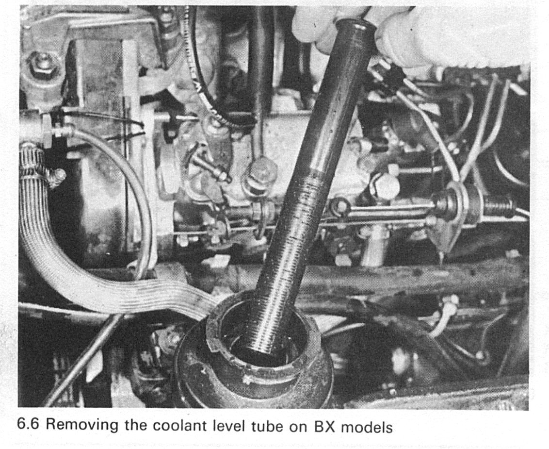

Early models had a level tube, with (admittedly Haynes) instructions to treat the top of the 'threaded' section as the Max level (when cold), and the bottom of the tube as Minimum.
Although the tube was long ago deleted, SFAIK the level recommendations were not revised (or were they?), and so the cold coolant level could well end up a good way down from the top row of the radiator, which seems less than ideal. I would have thought that radiators should always be full, to maximise cooling.
