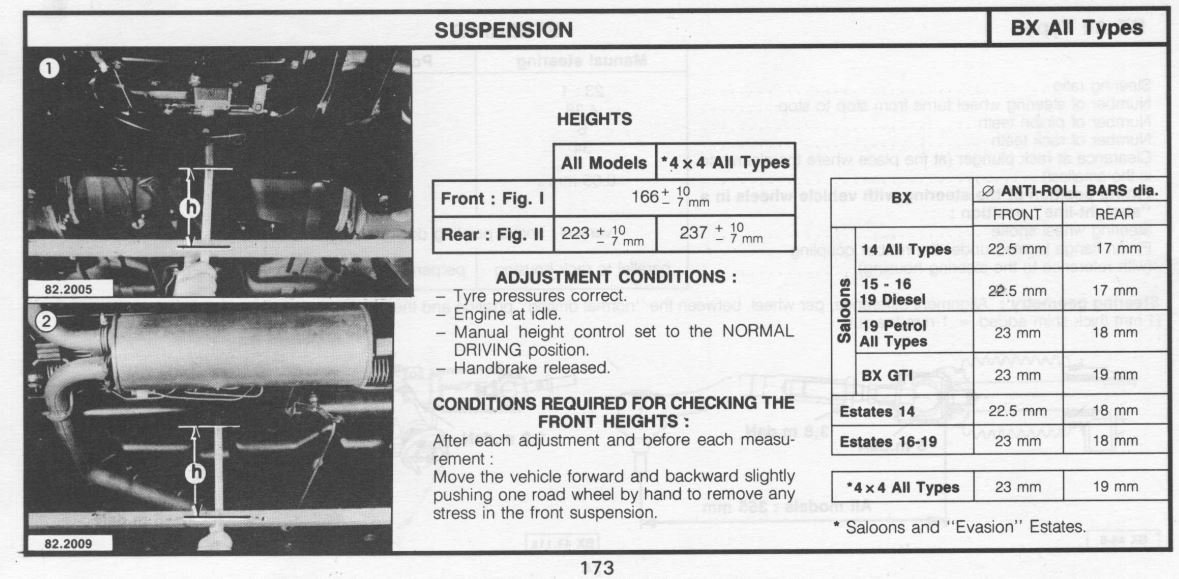

Pcheaven wrote: Mon Apr 05, 2021 1:38 pm Where should I measure the height from pls ?
I think Haynes lists the procedure, but this is the pukka Citroen data:
[Source: Private Cars, 050920 1992 AX ZX BX XM p.173]
:!: Car body MUST be adequately prevented from dropping suddenly if height adjustments are made. NEVER rely on hydraulic support when working underneath. A garage flatbed lift or pit (with ground level reference point) is the safest option.

Many thanks. This is very useful.
I have identified that possibly the front height correctors arnt functioning correctly. ( got two fat people to sit on the front bonnet. The car goes down but didn’t auto correct it’s height within10-20 seconds whilst still under load. Apparently this signifies the correctors need looking at. So that’s on the list for Friday when it’s in the garage.
Thanks all. Some excellent information posted for me. :)
