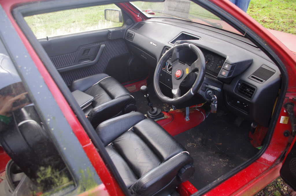

Interesting read so far. I notice your seatbelts are mounted to the floor. It has been suggested that in the even of an accident you can cause yourself some serious damage by doing this.
I have only scratched the surface, but most people recommend an FIA approved roll cage in the first instance, but at the very least a harness bar. It may be worth having a little google for some options/opinions.
HTH

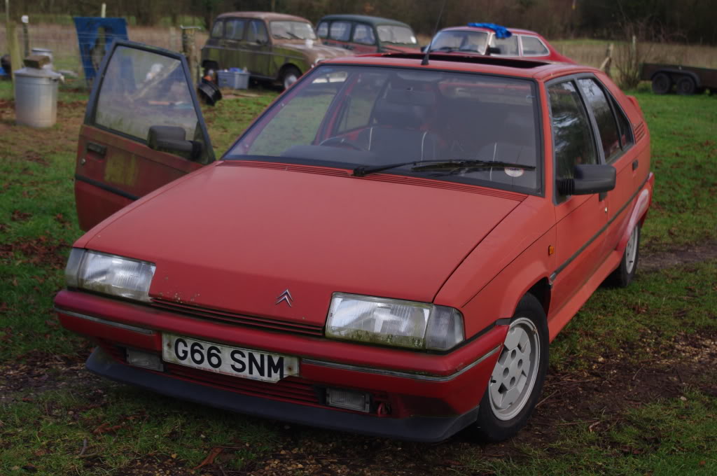

Alleluia! So next order of business was sort out the tyres. I had laid it up on one space-saver and four alloys. Nearside tyres were fine. OS front had deflated (dodgy valve cap). Luckily my dad recently bought a 405 Executive. Unluckily it turned out to have the structural integrity of a fondant fancy that's a week past the sell-by date. Luckily he kept the alloys so I could bung them on the BX to get it moving. Wheel swap completed, I ceremonially put the centre cap back on the steering wheel and tentatively put it in gear and drove it for the first time in over three years!
Only a few yards mind you but it felt good. Here is evidence. Phase 1s are the best looking aren't they?

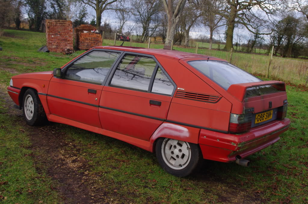

However, the OS rear made a loud scraping noise, meaning that either a) the wheel is the wrong offset, b) the rear arm bearings are totally fucked, or c) the wheel is the wrong offset and the rear arm bearings are totally fucked. My money's on c).
Anyway it all seems to have survived well, interior is in good shape and no evidence of water ingress.
