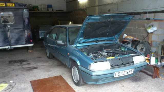

It was trailered over to my workshop the other weekend...

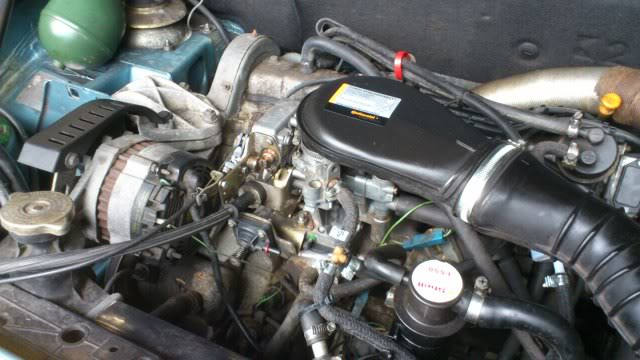

... where I removed the Carb ready to send it away to be refurbed. The spindle has worn the carb body to such an extent that petrol drips out when the engine is switched off and air is being sucked in when running. Once this is returned I hope to finally get to the bottom of the flooding/misfiring problem.
It's currently enjoying a nice (forced) rest next to my 007...

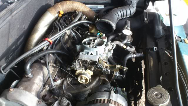

This morning my mate and 2cv guru Michael Knighton and I put the refurbed carb back on the BX. All the seals and gaskets have been renewed along with the accelerator pump and the leaking throttle spindle has been successfully sleeved. The solenoids that shut off the air to prevent run-on have been checked and are operating as they should but some of the levers that operate the choke were mis- aligned and therefore not opening or shutting properly:

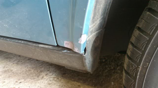

As well as all this fun, I have been sorting out a bit of surface rust that has crept under the paint in a few corners before it took hold:
