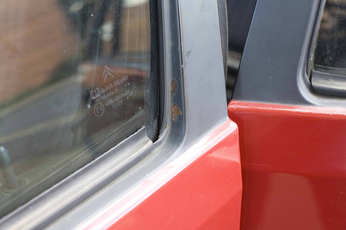

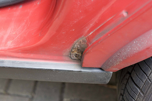

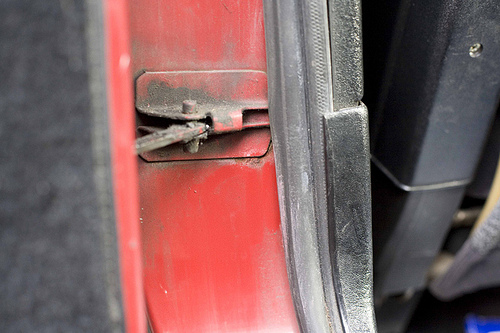

Noticing a few small rust areas, just wondering what people think about the best action, some of them aren't in the most obvious places really.
7 by Wooscary, on Flickr
6 by Wooscary, on Flickr
5 by Wooscary, on Flickr
4 by Wooscary, on Flickr
2 by Wooscary, on Flickr
1 by Wooscary, on Flickr
3 by Wooscary, on Flickr

That rust doesn't look too bad - my advice would be to wire brush as much of it off as you can, then use a phosphoric acid rust converter to get any you can't get to (a thin fluid will get right into the seam). Then seam sealant in the seams from the top, then paint on the top and waxoyl from behind. The A posts and bottom of the C posts are a common spot for BXs.

Thanks massively for that, exactly what I wanted to hear. It doesn't seem bad at all yet, but just wanted that reassurance.mat_fenwick wrote:That rust doesn't look too bad - my advice would be to wire brush as much of it off as you can, then use a phosphoric acid rust converter to get any you can't get to (a thin fluid will get right into the seam). Then seam sealant in the seams from the top, then paint on the top and waxoyl from behind. The A posts and bottom of the C posts are a common spot for BXs.
