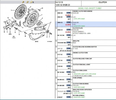

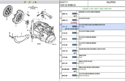

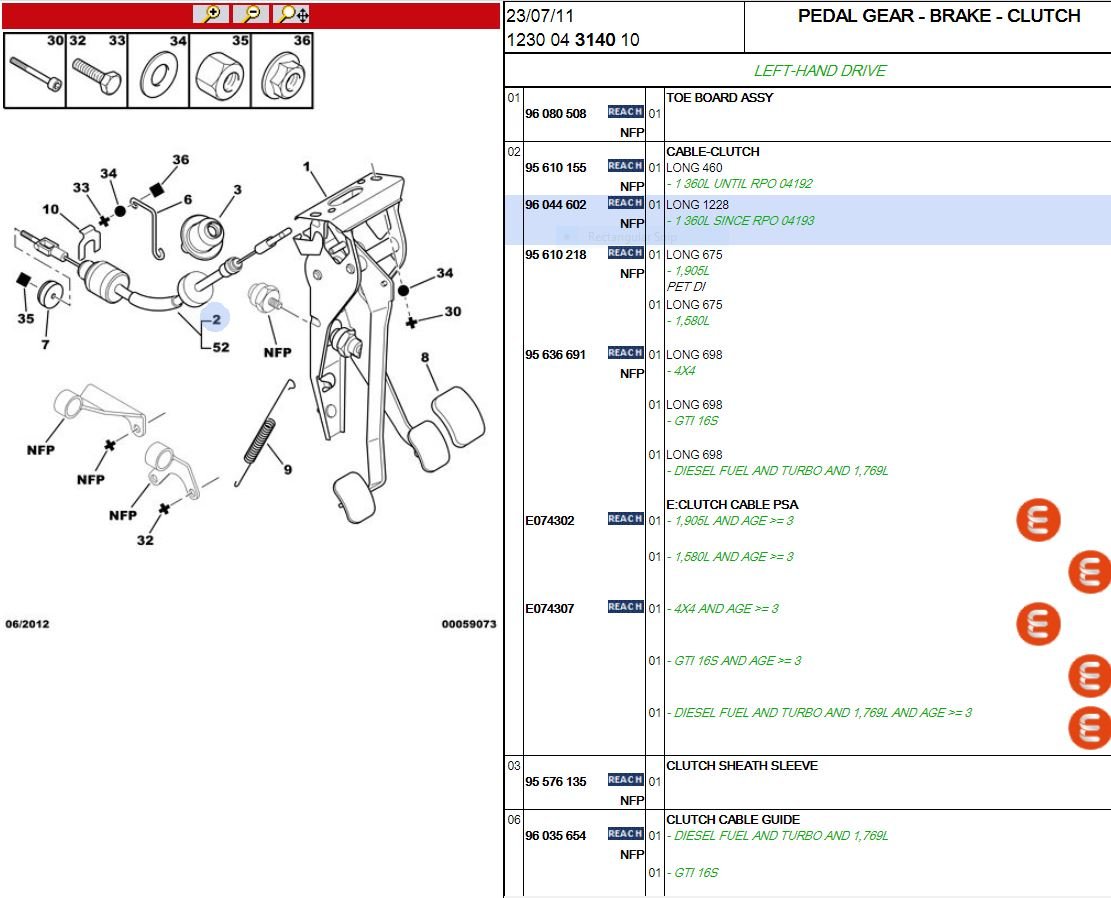

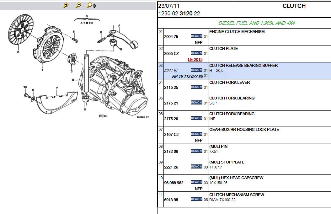

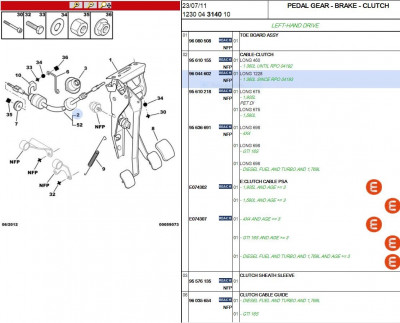

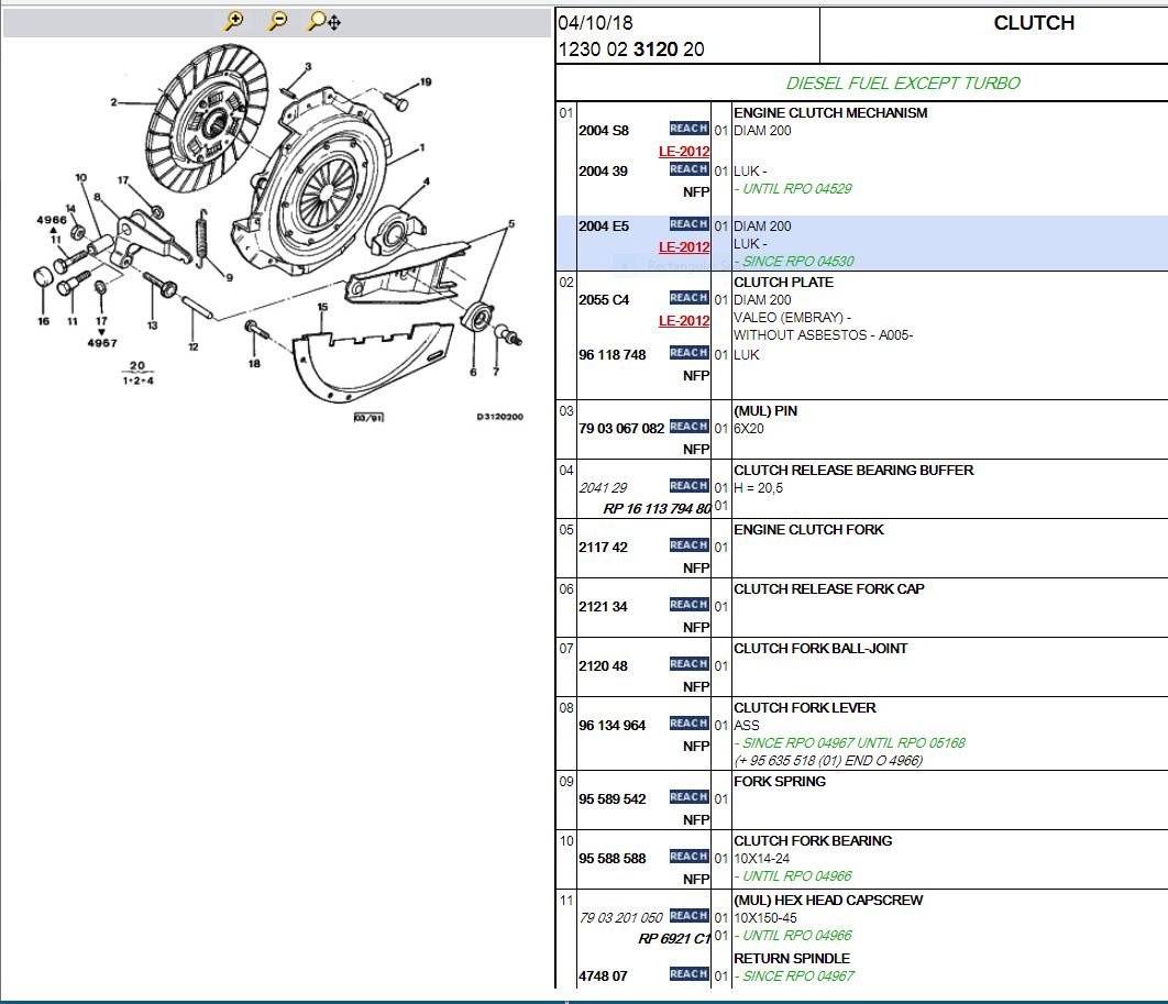

Some parts diagrams, in case useful...

In which case if the eng/box is out then why not, the TD set up is much better and less complicated.
