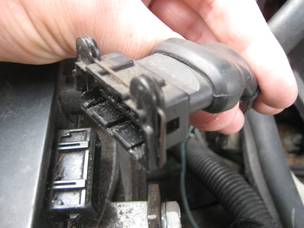

I have a feeling that this might have something to do with it:
I have basically come to this conclusion for a couple of reasons:
1) What was in the past a small niggle, has become a massive problem after I had to move the filter/AFM for access at the weekend, and the car has at times been undrivable...
2) I seem to remember Kitch mentioning a similar problem with his in this area.
3) The Induction kit has a bracket which is bolted to the AFM, but is not attached to the body... so it is moving around a lot more than it should, which really can't be good for the broken multiplug.
A couple of things to ask really...

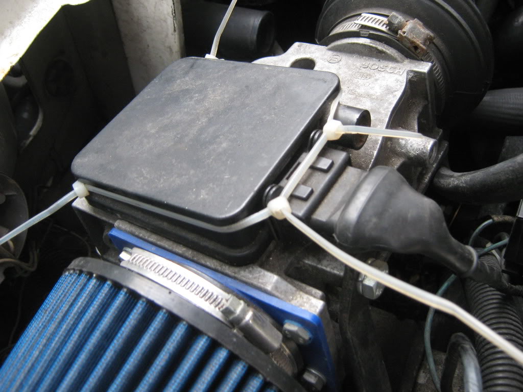

Would the multiplug (which has snapped clips and is held on with the pictured tie-wraps) cause such a problem?
Does anybody know where the bracket for the induction kit is supposed to bolt on?

I suppose this is obvious, but replacing the multiplug would be a good start. If you can find one.
Clean all the connections with IPA or similar, spray can is easiest.
Holding the connector on with a tie wrap should be OK so long as the terminals are clean and touching.
A better bodge may be to wrap a thin cable tie around the connector, then loop another round the AFM top and around each short side of the connector, that would hold it on straighter.
As an experiment, it may be worthwhile to refit the standard air box,to see if that movement is a problem.

I'll give everything a good clean-up and try to connect the multiplug in a slightly more secure way for now, until i get a new one.

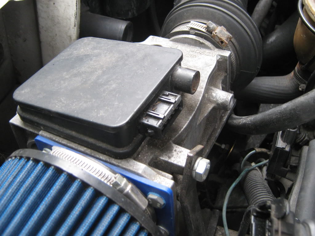

Having said that, it almost looks like it is the AFM itself which has been broken in the past... Which is a bit of a bastard (I really need to see how it should look before I buy a plug or airflow meter). Still, re-fitted the standard airbox today, and immediately noticed an increase in throttle response... going to give the car a proper run tomorrow into work and see if the problem persists.

Sounds like what I had, although mine had the worst effect with lateral movement, like going round corners. But that plug is alot more troublesome that you'd think once it plays up.
If it's totally shot, I'd chop it off for now and use some individual spade connectors. Won't be pretty (although you could use the rubber boot to cover it) but at least you ensure a good contact.

If it is your AFM I've got a spare on you can try if you ever pass by! Only other thing is check the wire to the crank sensor hasn't had the insulation torn anywhere. But I'd almost bet money your problem is that dodgey plug.

Since I cleaned and re-bodged the multiplug, as well as re-fitting the standard airbox (I'd forgotten how nice they sound as standard ) it has been behaving itself.
