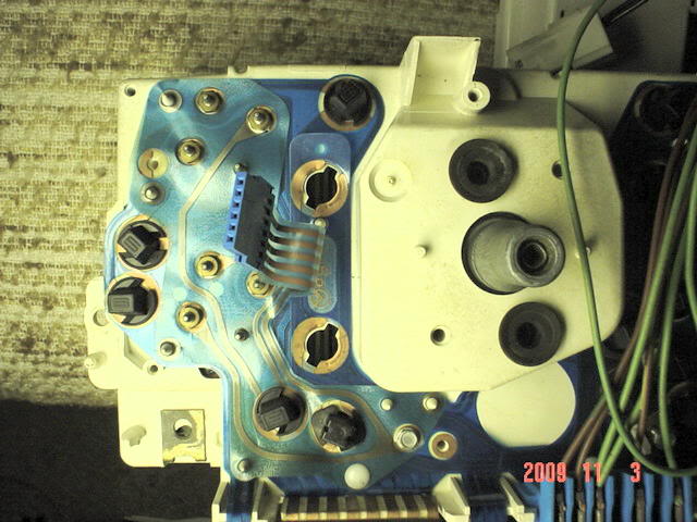

Well, if it is the Veglia dash, then there is no ilumination to the left hand side of the petrol and oil gauges, but there are 2 located on the letft hand side of the speedo head as you look at it.
To get at them, you have to remove the white plastic cover over the small PC board, 1 screw, then you will see them.
I will try and get a photo up later.
Good luck and have another cuppa.

Picture below.
The two bulbs in question have been removed to indicate the ones that require replacement.

All sorted now thanks again Brian, every single dash bulbs works (for now) even the auto shifter! lol
