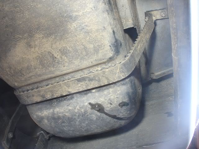

BX reserve tank strap
Not sure if this is the same thing you are on about... but a few years back some handy mechanic replaced the rusty band that was on my Series 2 with what appears to be a used cam belt! Nicely held in place with a washer and all!
Mark T.
Melbourne, Australia
BX16 TRS Auto (Series 1)
BX19 TRS (Series 2)

Very similar Mark.
i suspect that yours is secured with a nut n bolt both ends whilst the metal strap i used is hooked through a couple of slots and only secured with a bolt on one end. Works fine for both of us as mine went through the MOT on Wednesday with nothing needed to be done. Not bad for a 17 year old motor.
