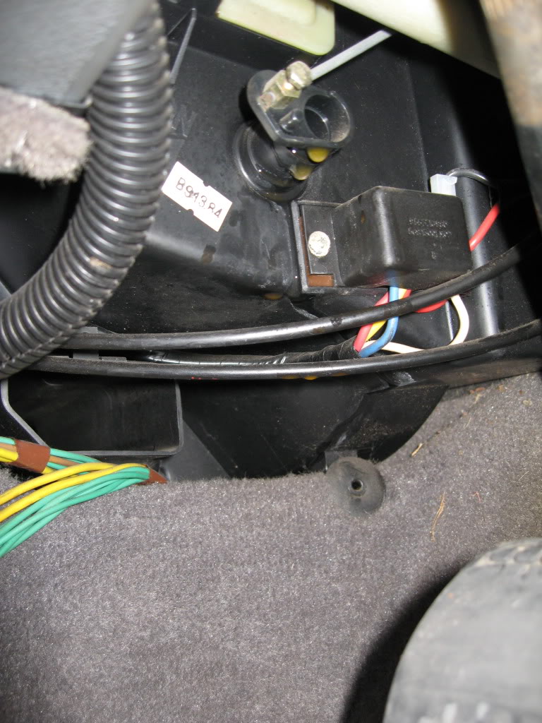

Well as the title implies my car has sprung a water leak...from the inside!! Well Citroens do like to be different...
Ive taken some photos and ill upload them after ive posted this.
All i know is its develpoped since we got the car back from the garage and to be fair to the car it has just done 400 miles in 4 days ( ).
Anyway the leak is in the drivers side footwell on the gearbox/far side and is coming from a black pipe which is coming out of/attatched to the interior plastic.
The liquid appears to be water but is a yellowy/browny colour.
I know youll do your best but please help me because if my dad figures out its broken he'll go on about his Audi being superior german build quality etc!!
Thanks
Phil
Thanks
Phil

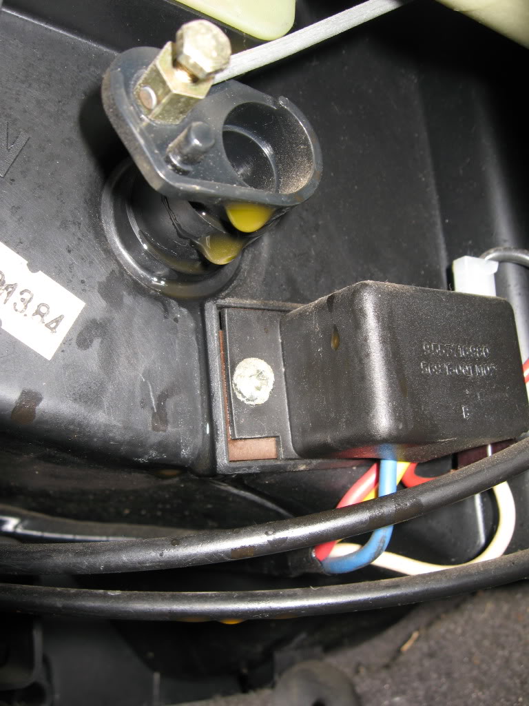

Actually I fear it's worse than that If the water is coming from where the 2 drips can be seen in photo 1, it's the heater tap itself, not the matrix
The matrix is a fairly straight forward job, but the tap is something else

Hi Phil,
Well, my money would be on a leaking heater matrix.
The pivot shaft with the two drips on the bottom is attached to one of the transfer flaps, and it is possible for a leaking matrix to drip onto the transfer flap and find it's way to that pivot.
To eliminate or confirm a leaking tap, dry all the existing drips and wet areas, then start the engine till it reaches running temperature, then operate all the flaps, and observe the area.
Strong light and mirror may prevent a stiff neck.
Good luck.
Good luck.

ok ive had another look. I tied to take some photos but its too inaccessible.
The black pipe is actually bone dry on the inside and the drip is from a large white plastic pipe/tube above it. Right from the join i think (its screwed togther. The water drips from this down the plastic facia and around the black pipe/pivot mechanism.
However there also appears to be some moisture, although no drips around the black plastic tubing above it...
ill try again to get some pictures and see if i can find a better torch for a better view of the white plastic tube and black plastic above it.

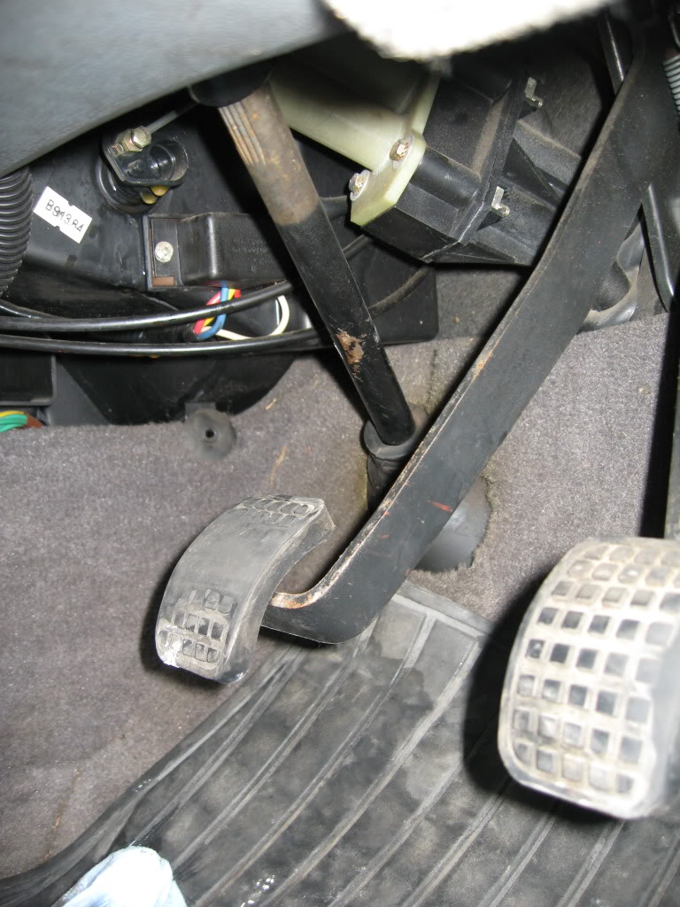

right o had another look by wedging my head between the pedals and the facia panel and using my 'c8 credit card torch'..
The water is definitely comnig from the white box which appears to be clipped in and is directly above the black pipe. It bubbles up there and then drips down. (the white box being above the plastic facia panel which reads 'Chausson'- shouldve stuck to buses i think!!)
The white tubing is then screwed into the another piece of white piping towards the bulkhead.
So i take it then that this is the heater matrix (although i thought it had been done ).
If so are these readily available new? Although i had a very kind offer of one from a member if one is readily available locally then i might get one for the sake of expedience.
If so where, how much etc. Also what equipment/tools would i need to do this job myself? Already it looks liking unscrewing bits to gain access but are any sockets etc required? I dont have many so i dont want to start unless i know i have the tools to finish can finish....
Thanks very much guys for all your help it really is much appreciated.

I know someone here in Wakefield that currently has a BX breaking for parts that had a new matrix very recently. I'm sure he'll let you take it for a small consideration. But you'll have to be fairly quick as it's supposed to be gone this week.
It's also the best way to learn how it goes back in, if you remove it yourself.
