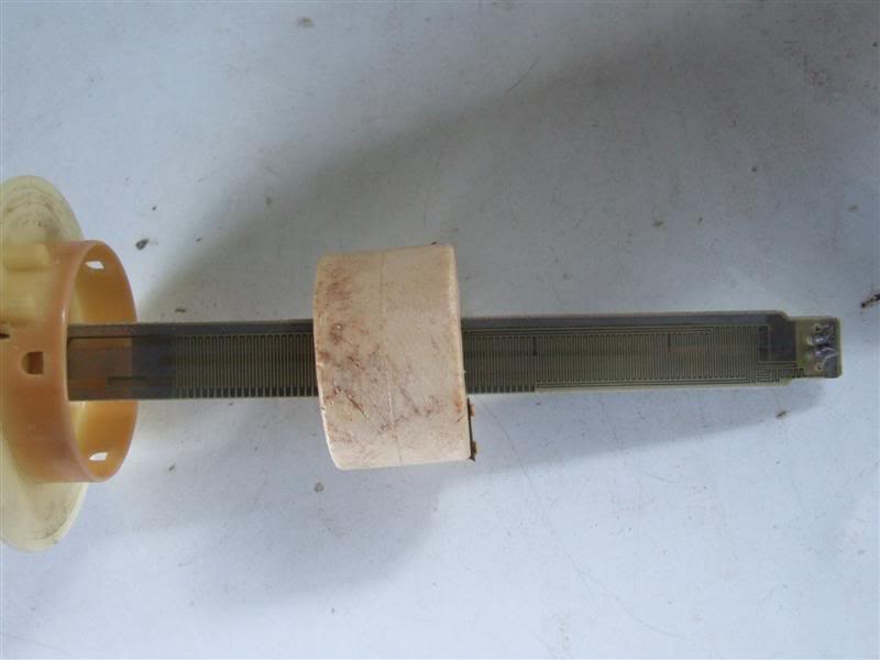

Here is what is inside the fuel tank sensor

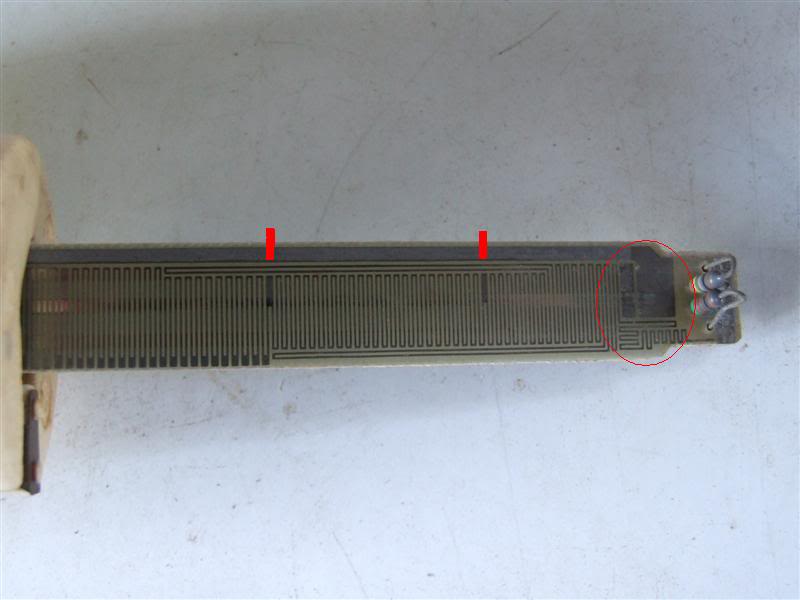

What I noted were three distinct marks on the way down the sensor which I marked two on the photo indicating 1/2 and 1/4 fuel points.
The trigger for the light is in the area circled. Which you can make out half the circuit is missing. On the float is a metal clip that floats up and down and from what I can see that clip when it reaches near empty no longer has a connection hence activates the light.
All boring technical stuff really.

Petrol in liquid form is not flamable the vapour it gives off isJayW wrote:Potentiometer + 12v + Petrol = no bang!
The wonders of electrickery...
Electrical current does not cause the bang the spark does
Did make me wonder though when I saw those electrods submersed in fuel to wonder how often a fault has occured to cause a fuel tank fire.
