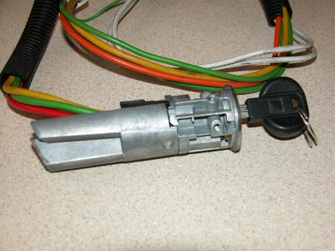

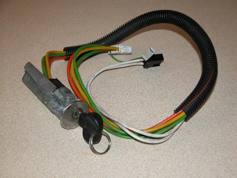

electrokid
Posts: 1764
Location: Woking
Post by electrokid »
Hi Nat,
Does it look like this ?
Can anyone else confirm this is the right one or not ?
NOW SOLD :-)
2002 C5 HDi SX estate
Contact:
yep, that'll do it, that being the generic later style one that will replace the full 8 wire harness as a direct plug in.
