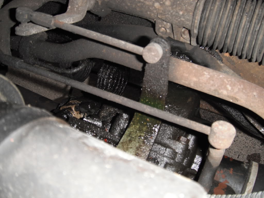

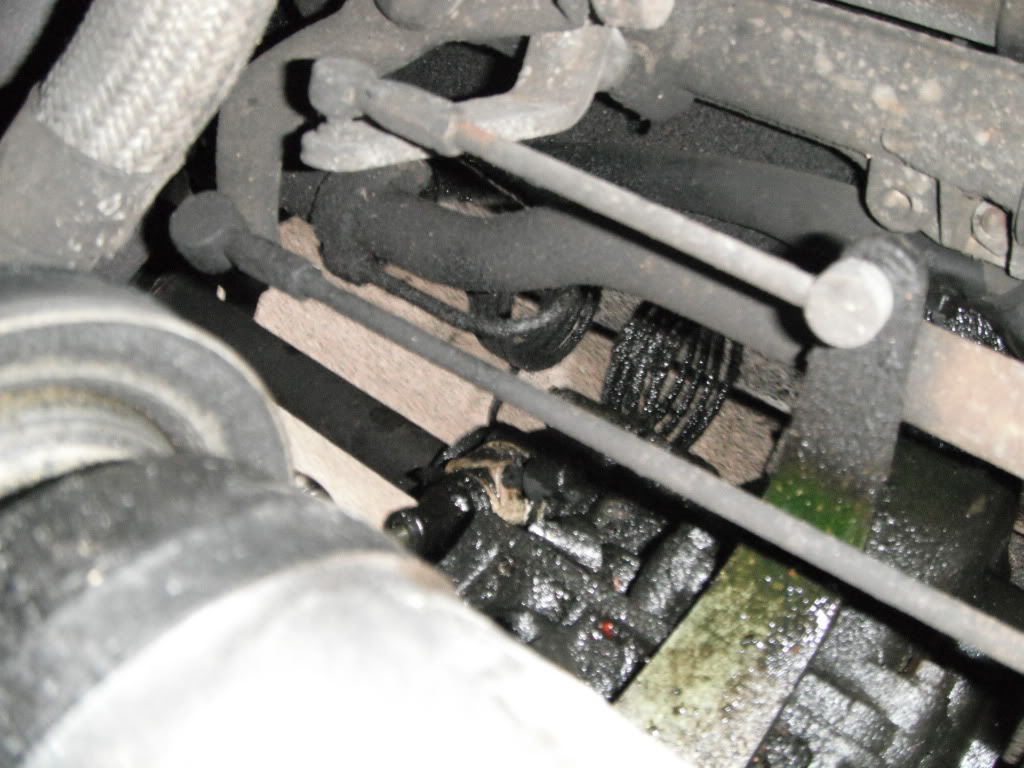

do these shed any light on my leak? the dash light never came on whilst we drove 15 mile round trip looking for a motor factor who was open.....
that must mean not a pipe off? if it was i imagine it would lose the green stuff quicker?
seems to be coming from this area and dripping down the back of the engine.

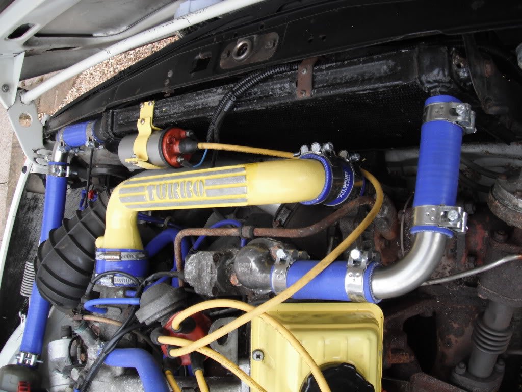

gratuitous picture of the saab engine bay which got some much needed cleaning and inner wing polishing along with a freshly painted coil and bracket.just off to the shed now to top coat the overflow tank brackets.

bit of a result there.got charged eight ponds something for 2 litres,was supposed to be 11.49 a litre. feeling a little guilty now....but not too much.............

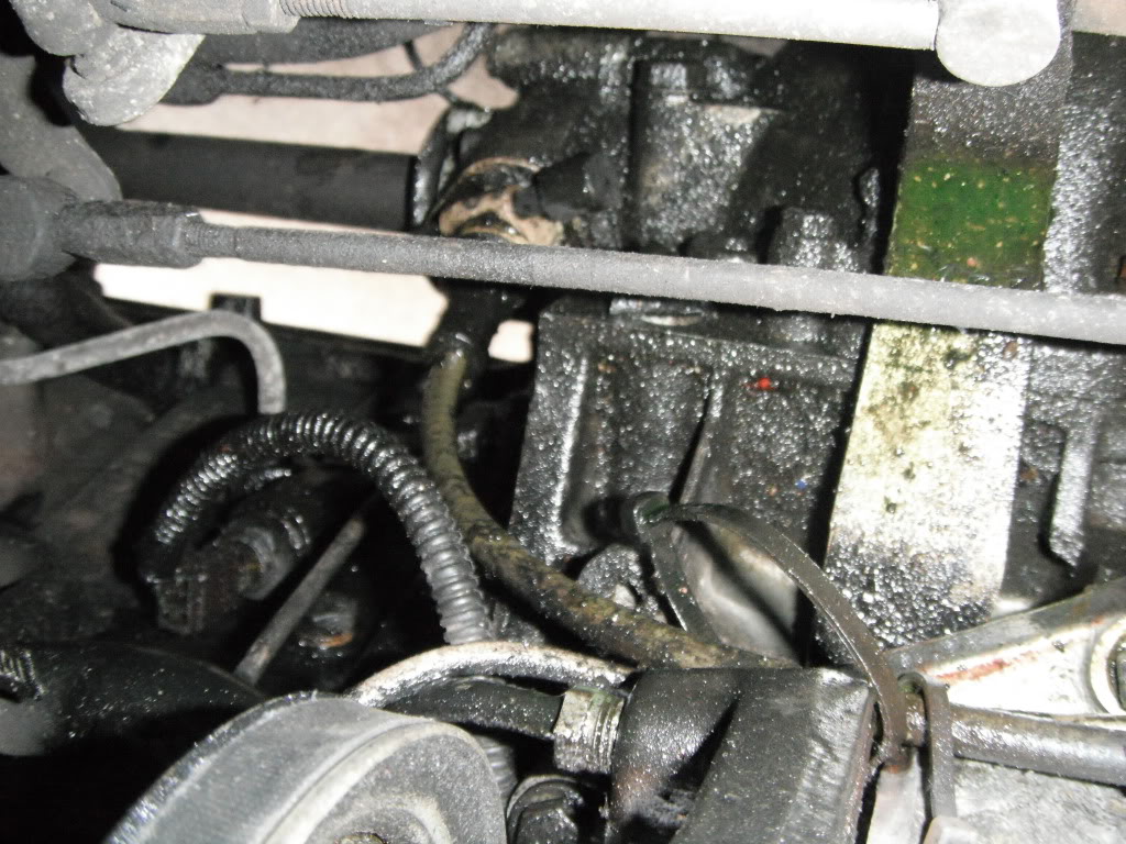

It sure looks (Fig #5) as if it were coming from the pump pressure pipe union. But you can never tell for sure except by actually looking at the situation live and judging by yourself.

if the green stuff is only here as a result of me playing with the suspension height i can live with it.i will nip up that union anyway as a precaution. other than that im really happy with the car so far. radio 4 still working loud and clear..........

That's the union, but as I said, it's very difficult to tell based on just a picture.johnbird wrote:is that the union which looks like a brake pipe? screws into the pump body?-the pump im presuming being the part on the right which is driven by a v belt? looks to be a 10/11/12 spanner.
There also seems to be another pipe (unfamiliar to me) with a physical contact with the pump pressure pipe. That shouldn't be, even though it probably isn't the cause for this leak we're now talking about.
