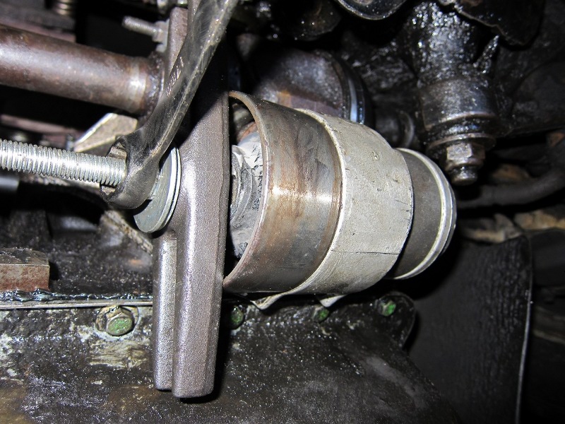

Was pretty tight, but managed to do the job underneath the car, using the new bush as a driver, and the outer race of a scrapped front wheel bearing (with the inner diameter machined to 73 mm) as a pulling tool: http://www.rmattila.com/images/remontit ... vaihto.JPG . Luckily, the weather was nice: only -10 degrees C and quite dry. What a nice way to spend a Saturday afternoon engaged in healthy outdoor activities!
Heat was required quite a lot, and yet I managed to break one 10.9 M10 threaded bar by pulling too hard.
For making the work easier in the future, I made a driver tool from the old bush: http://www.rmattila.com/images/remontit ... painin.jpg. However, next time I change the engine, I will remember to check the condition of the bush before putting the engine in place.

The rubber from the lower bush had broken, and the engine was able to move so much that the RHS inner driveshaft joint cup hit the surroundings when accelerating heavily. No need to change anything else besides the bush (# 1809 16 , cost 9,90 Euro), and besides, changing the entire mounting is quite a job: the driveshaft support bearing is in the same unit etc.

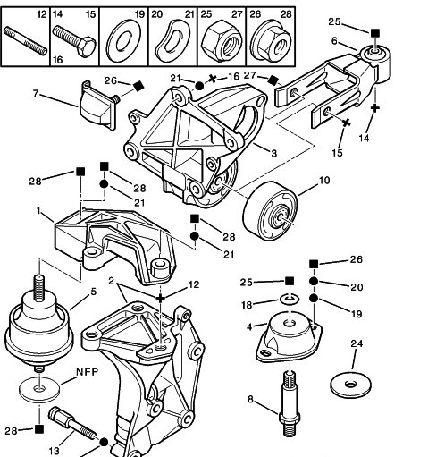

Aha, if the engine is supported from beneath, is there any reason why the whole bush can't be replaced easily? Or is it a case of having to take the driveshaft out justincase it gets damaged?
There seems to be a confusion of terms: what I changed was the bush, including the metal parts (# 10 in the figure below), rather than the entire mounting unit (#3).

Yeah, no 10 is what i'm on about, i thought that bush had an outer metal surround? This is what i presume you left in place & just replaced the rubber section inside it by making up the tool to push it out whilst popping new rubber straight in?
No, I changed the entire bush, using the outer metal race of the new bush to push the old one out. In the picture below, from right to left:
- aluminium bearing tool pulling the new bush inside the mounting unit
- new bush, outer metal race visible
- the engine mounting unit
- scrapped front wheel bearing outer race, used as a pulling aid
- the old bush (including the metal outer race) coming out from the mounting unit and inside the bearing race
- bearing tool fork
- spacers and a nut for providing the pulling force between the bearing tool fork and the aluminium bearing tool

IMHO it is much easier to take the old one out first before trying to put the new one in. A bit of heat will de-bond the old rubber if required and then take the blade out of a hacksaw frame and feed it through the bush ring before putting it back in the hacksaw frame, use this to cut through the old bush ring only and it will then all but fall out. Use emery tape to cleanthe housing face and coat with grease before easily using your puller to fit the new bush.
I reached the same conclusion during yesterday's activities.Defender110 wrote:IMHO it is much easier to take the old one out first before trying to put the new one in.
I took the ring of the old bush, machined 1 mm off the diameter, and welded a 15 mm plate with a 10 mm hole in the centre to the other end (figure). With this tool and sufficient input of heat, I hope the next change would be a bit less troublesome, as the old bush can be removed first before pushing the new one in. If not, then the hacksaw method will probably be the next approach..
