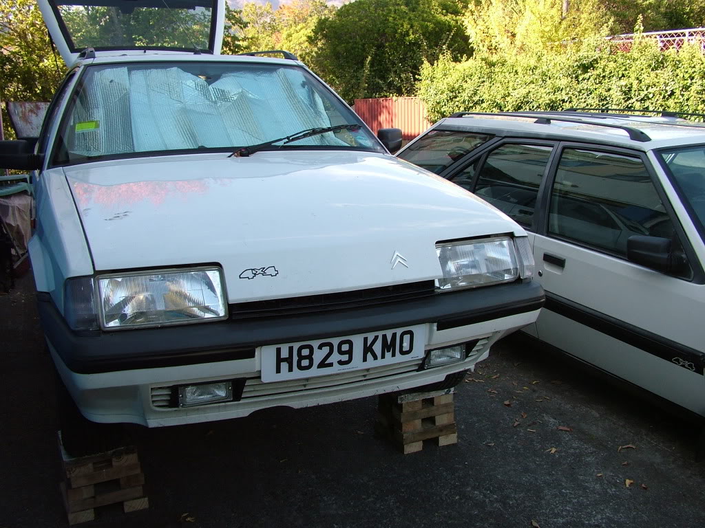

Here we go, It all started a few months ago. And now it wont stop untill i have it on the road.
there is always a way.
I have had this car since i bought it from a scrap yard, it had hardly any exhaust left, an LHM leak, and a massive list that i made on the drive home.
have done everything, there is nowhere i have not had to bits and rebuilt now. I really enjoy the BX 4x4 it is a great bit of kit.
I converted the interoir to Black as it was a bit crap in grey. so that came out of a scrap 93 TZD estate. it has been a great challenge to find the parts that Citroen will no longer supply and making parts up my self has been a lot of laughs.
So then i moved to New Zealand and could not afford to bring it. so i stored it up for a few years in a barn, untill the day came that i got it out here. along with the parts car. an identical match to this one.
and then it began the big strip and clean hack back and rust cut out sessions and then rust treat the surface rust and paint.

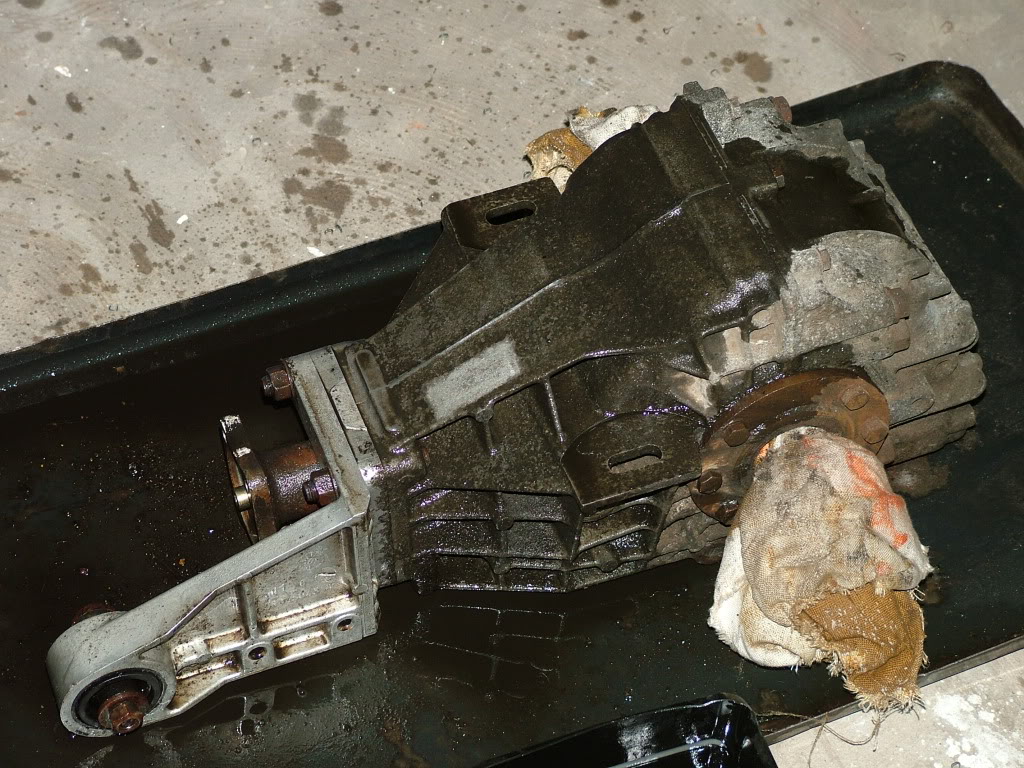

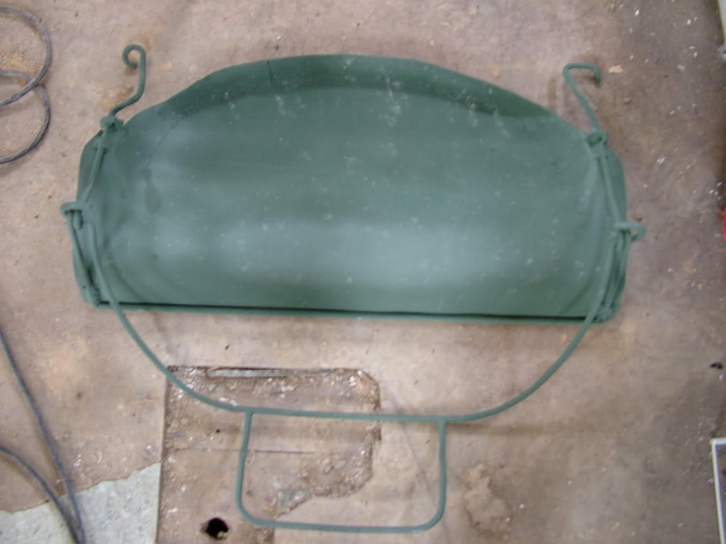

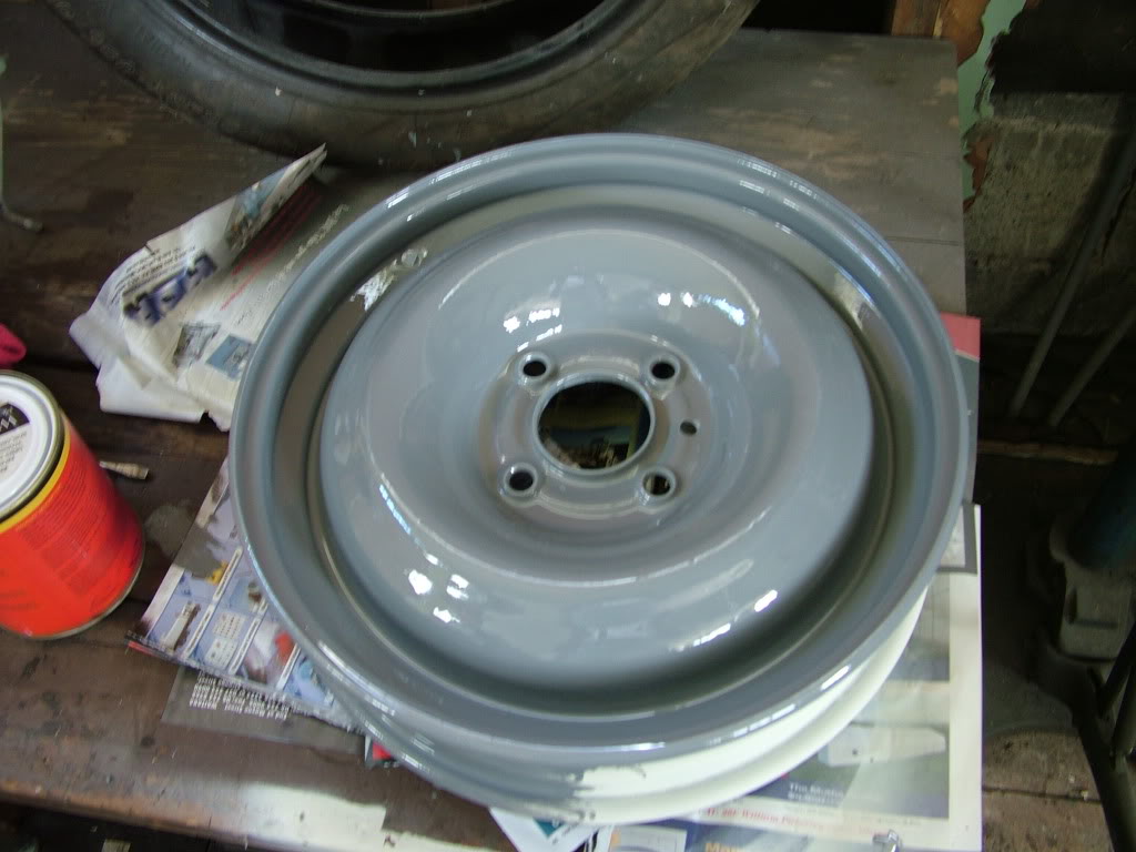

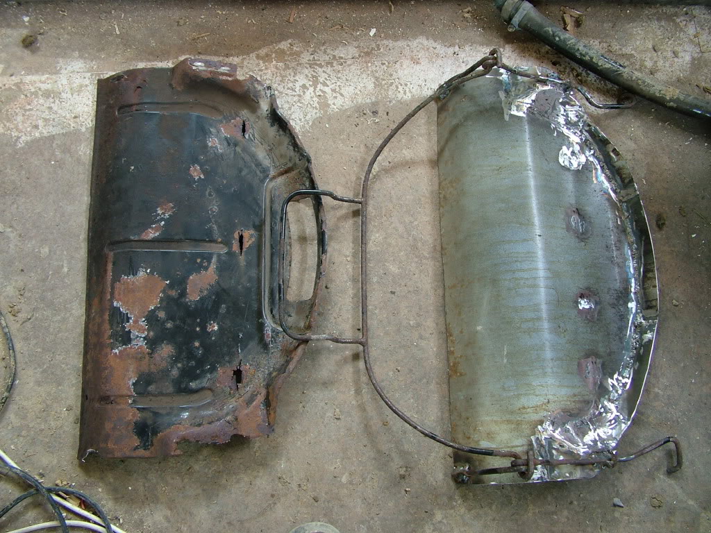

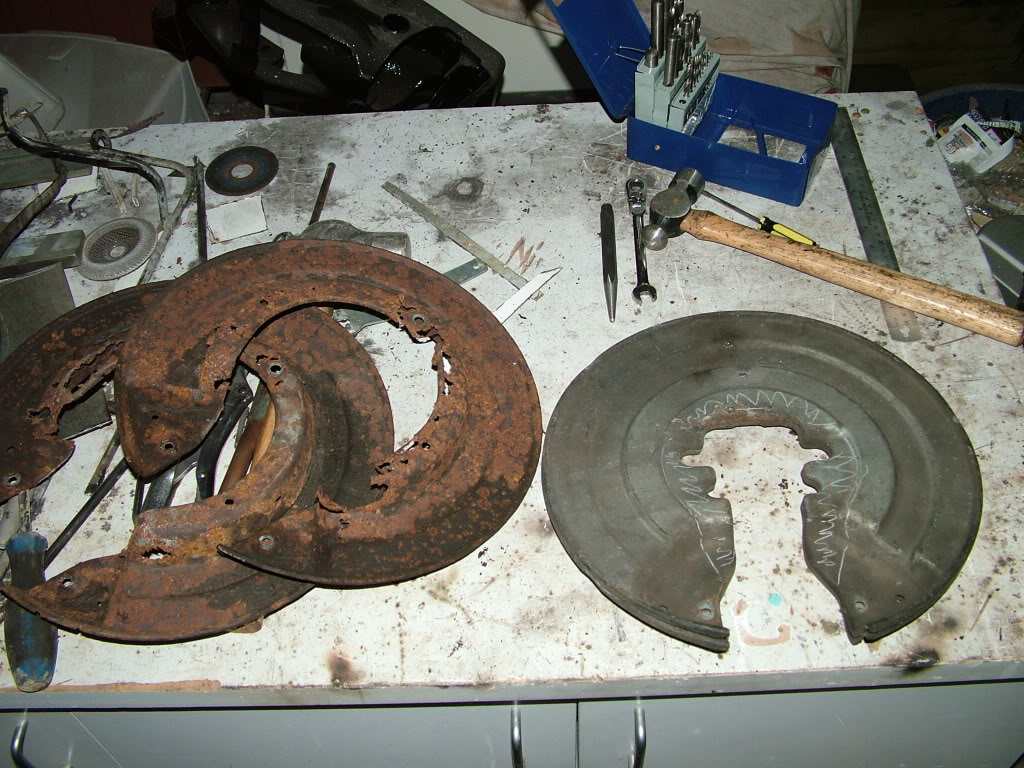

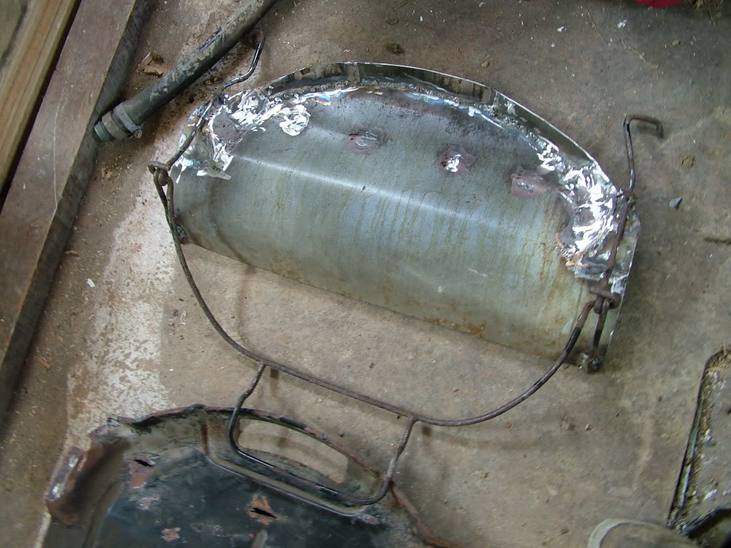

Then there was some repairing and making of the Parts that were falling apart.

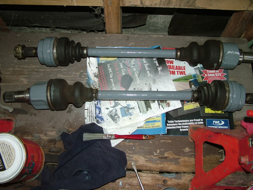

BX 4X4 Resto

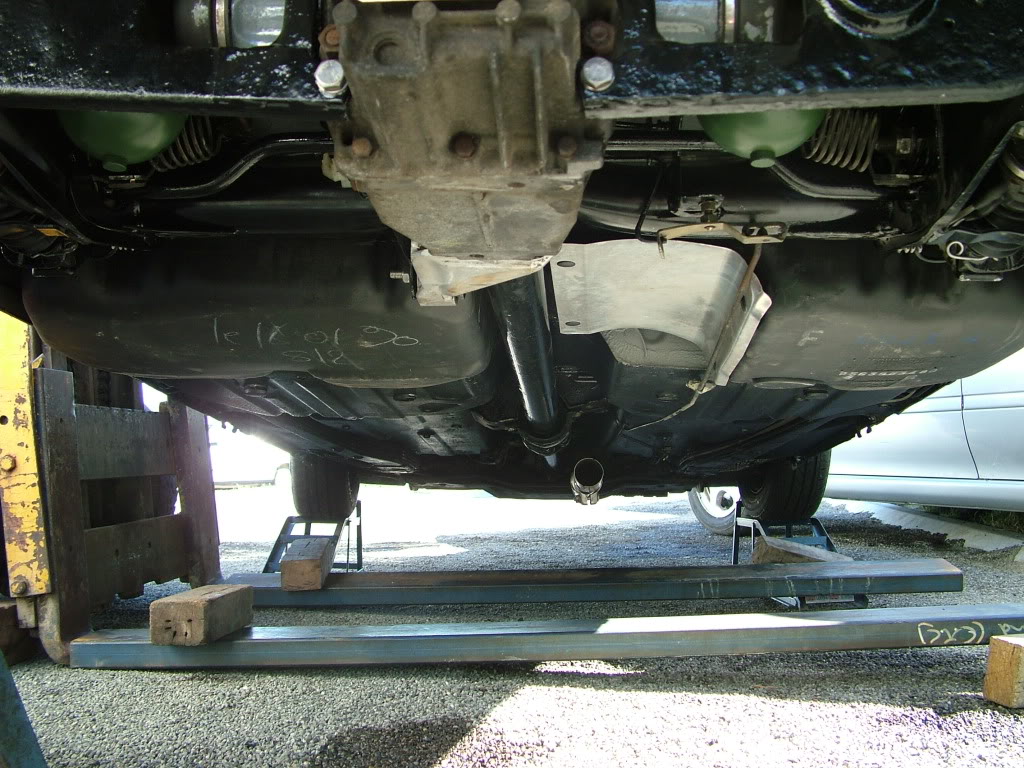

Then it was time to start bolting it all back together, it was a very good day. nearly everything is just how i want it. i now have some body work to take care of then i will start on the front subframe.

BX 4X4 Resto

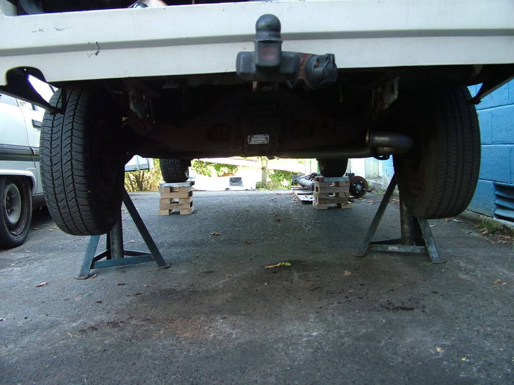

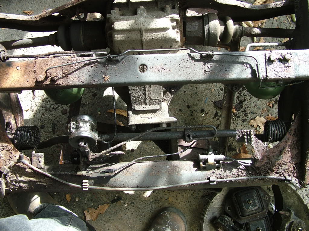

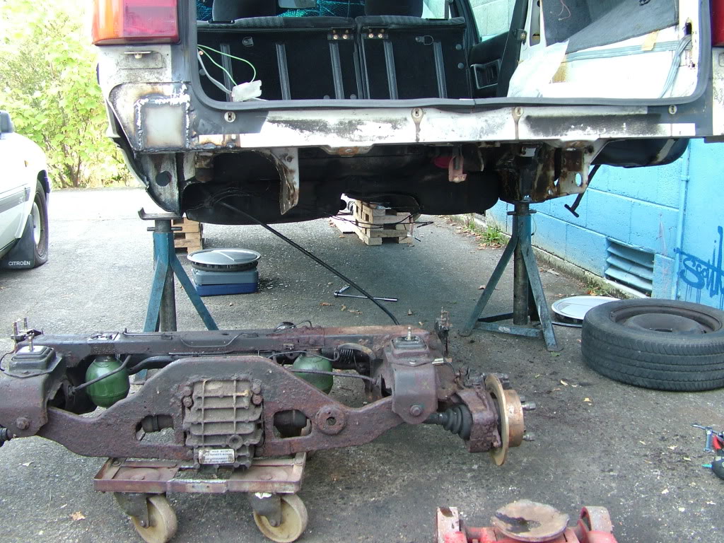

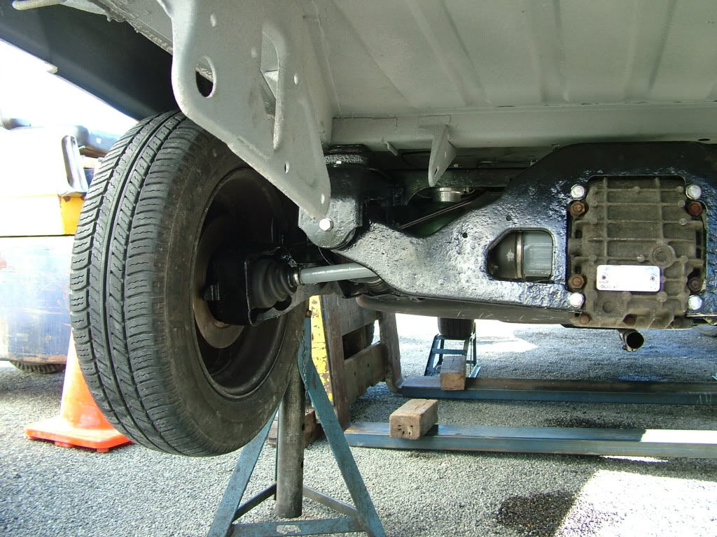

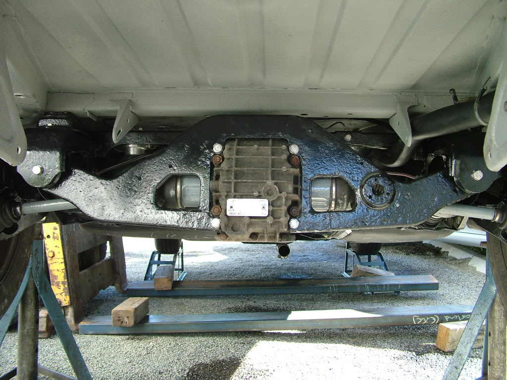

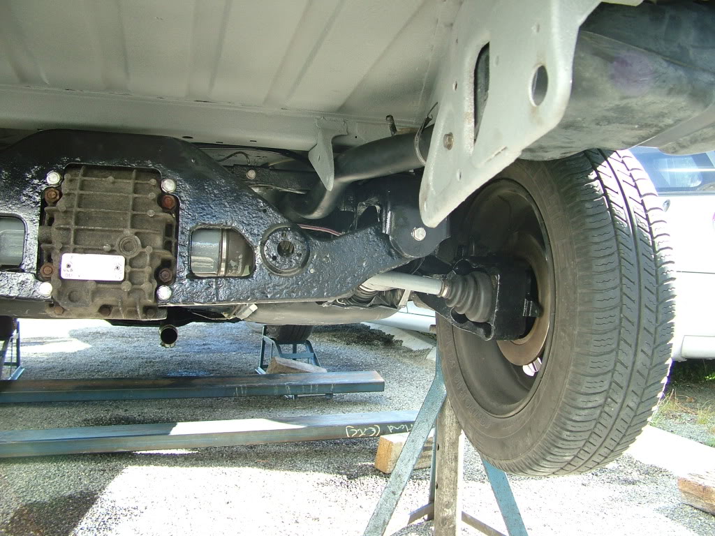

As you can see the rear subframe was really quite corroded but surprisingly it was all a lot of surface and with a blast and paint is now looking as good as it can. I have got another new subframe but i thought i better save it for another day as i have got a new Torsen diff from a GTI. but i stopped myself from using them yet.

So once the propshaft is disconnected, is the rear subframe as easy as a 2wd BX to remove with just the front-rear hydraulic pipes and suspension control rod to worry about?

once you have the rear prop off you just pull the front to rears off then you give it some wriggling then it comes down nice, going back together i have found it better to bolt the mounts to the car loosly then bolt the mounts to the subframe onec they are in as you find yourself manouvering it about a lot once you have the front mounts in. but i was doing most of the work by myself so if you have a hand that would be better.
i am writting everthing down that i have found is the same as a Normal BX and i am compiling a list of things as i come across them that you can use from other citroens and more.
so if you find yourself in the shit and have been told that citroen wont help, get in touch and i will steer you right.
i really dont know why people are scared of the 4x4 it really is a peice of piss to work on and an enjoyment i have found to restore. now i start on the front end once i have sold my XM. to many cars not enough money to keep them all.
