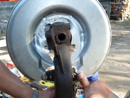

Part number is 95 630 820, but unfortunately they are not manufactured anymore. I've made new ones from Volvo 740 plates:
Someone told me that Xantia plates would be an even better starting point, but I haven't yet tried that myself.

xantia ones do fit with slight mod. i made my own from cx ones once. but had to spend a lot of time cutting.
