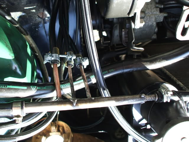

Ive made up a mk 1 :)trial metal extension to take all 3 small pipes & the main feed back to tank,& silver soldered it all together ,all 5 holes have a different internal diameter,right pain in the arse ,,,seems ok at the mo,,,,,,,,if it works ok for a week or so then i will make up a more robust version .

Can you post up a piccy of your homemade set of pipes that you've made?

Ive changed the suction pipe & throtle cable positions since the photo was taken to avoid rubbing ,,,,hopefully the mk 2 will be a bit tidier.as i had to cut the rubber pipes back to get sound conections, but lets make sure it works ok first.
Cheers for the diagrams of all the pipe work, now ive calmed down a bit they make some sence,,, ........rich.
