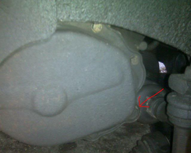

There are 2 plugs that i remember, is there a diagram to show whereabouts they are & which one is the one to drain the oil & the other to fill up?

This is the filler plug (well, at least it's been where I've been putting gearbox oil for the last 110k miles! :lol: )
I change mine every 24k miles, which I think is the recommended frequency. Drain plug is at the lowest point, at the back of the diff housing near the subframe. They do have washers but I've always re-used the old, with no issues.
