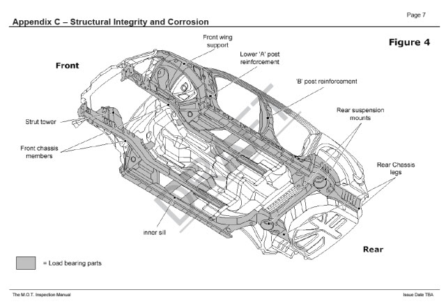

'withinn 30cm of any structural member'
All I can find is the reference to corrosion in load bearing areas (figures 1-4) which are things like the chassis rails, sills, inner wings etc; and 'prescribed areas' which are defined asThat said, I reckon it will have *some* effect on the structural integrity, but not be an MOT failure.The load bearing parts of the vehicle to which the testable items defined in Sections 2, 3 and 5 of the Inspection Manual are mounted, and
any load bearing or supporting structure or supporting panelling within 30cm of the mounting location.

Not according to the MOT manual though - but I agree with your logic and that it *should* be welded in an ideal world, just that I don't see it to be an MOT failure. Sorry if I sound a bit pedantic about this, but part of my job involves reading and interpreting standards (and sometimes having to justify that what we are doing is within what the standard specifies...)Defender110 wrote:a boot is also surely a 'load bearing area' as its purpose or use is just that to carry a load?

That comes under the 'prescribed areas' and are defined as:Defender110 wrote:How about ''Supporting panneling'' within 30cm of a supporting structure, i.e. the rear chassis leg?
2 is steering/suspensionThe load bearing parts of the vehicle to which the testable items defined in Sections 2, 3 and 5 of the Inspection Manual are mounted, and
3 is brakes
5 is seat belts
So I read that as anywhere to which steering/suspension/brakes/belts are mounted to, and anywhere within 30cm of that mounting point.
(Note that the actual wording states "any load bearing or supporting structure or supporting panelling within 30cm". In practice, without a knowledge of monocoque design I guess it is difficult to prove whether a particular area is load bearing or not, so in practice it would make sense to err on the side of caution and treat everything within 30 cm of the steering/suspension/brakes/belts mountings as being potentially load bearing/supporting).
Although NOT everything within 30cm of the areas defined in the pictures as load bearing. To me, severe corrosion within 30cm of a chassis leg for example, *must* have a significant effect on the safety in a crash, so perhaps it should be an MOT failure. However I can find nothing in writing (the only thing that would stand up in a legal sense) to suggest that it would be a failure.
