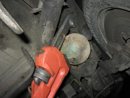

Not necessarily so hard, but there's not too much room for pipe a wrench or similar around the accumulator sphere. However, the mallet-and-chisel trick, even though it sounds a bit rough, is actually rather a smooth and non-violent way to remove the sphere. Put the tip of the chisel along the weld seam, hit a couple of times, and it usually starts to turn.2BXORNOT2BX wrote:hope it doesnt come to that...are they that hard to get off sometimes?
Then continue by hand.
And, when putting in the new one, remember to put some vaseline to the thread, and tighten it only with your fingertips - no need to use any force to make it leaktight. (One sign of a well-kept BX is that the spheres come off without any tools!)

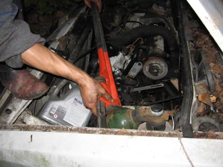

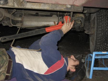

the odd time i had probs whilst useing a 30cm pipe chain wrench,
it would not budge till i noticed the chain was snagging on the web in the corner of the crack case behind the sphere,

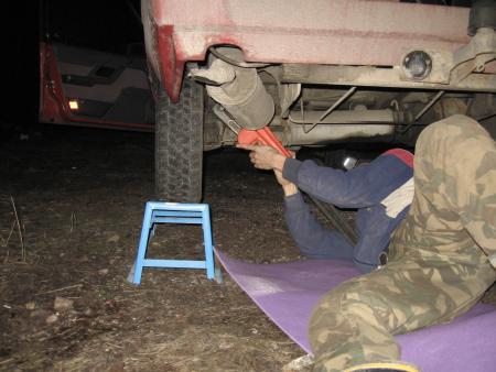

I suffered some 15 years with pipe wrenches and such (even the chisel every now and then), but this summer I finally spent the couple of hours making the tool:
Thinking back my life, should've done that a long time ago..

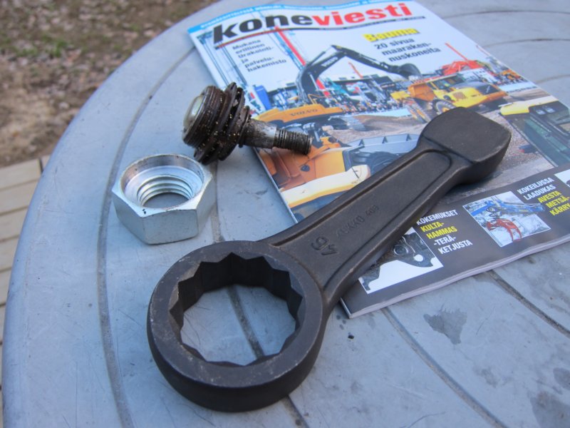

Another ultimate solution - if everything else has failed - is to take the cap off the sphere and let the nitrogen out, and then weld an M30 nut to the base of the sphere. Then put a 46 mm strike wrench (such as in the picture below) around the nut and hit once with a suitable fine-tuning hammer.

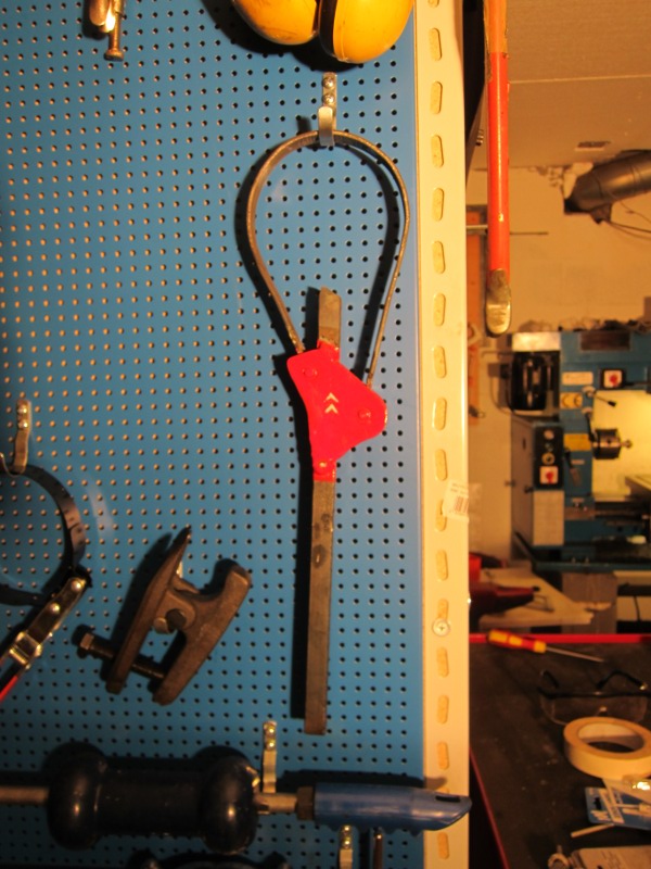

Kitch wrote:Just buy the proper tool? They're down to something silly like £20 on ebay.
these are not the proper tool, as the proper one is similar but the steel band has a split with a pinch bolt which pulls the steel band tight against the sphere,
i own one of these clamp it to the sphere and give it a little bash with a club hammer,
