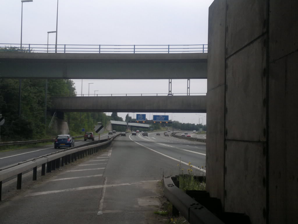

It sure doesn't look like a good place to end up to, wrong side of the road and all.. :lol:
