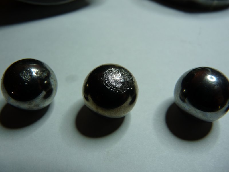

You can also buy the five-by-eight inch bearing balls separately. In most cases I've found that by changing the six balls when symptoms emerge, you can double the life of the other components of the joint.

So the ball bearings wear without weaing the case sockets? Does changing just the balls stop the clicking/ knocking noise or just extend the life of a noisy jointrmattila wrote:You can also buy the five-by-eight inch bearing balls separately. In most cases I've found that by changing the six balls when symptoms emerge, you can double the life of the other components of the joint
Wear in the sockets does not usually cause clicking, since the cause is more often cracks in the ball surfaces:Defender110 wrote:So the ball bearings wear without weaing the case sockets? Does changing just the balls stop the clicking/ knocking noise or just extend the life of a noisy jointrmattila wrote:You can also buy the five-by-eight inch bearing balls separately. In most cases I've found that by changing the six balls when symptoms emerge, you can double the life of the other components of the joint
The sockets easily outlast a ball set or two before the actual wear and increased gaps become a problem. Usually it's just the failed surface of the balls that cause the sticking & clicking.

Yes very interesting bit of knowledge that I would have doubted if you didn't have such obvious great knowledge of high mileage BX's. I think I will have to get a stock of ball bearings then.BX Meteor wrote:/\ Wow that is an awesome bit of knowledge to pass on
Is 5 by 8" the size of the bearing to ask for then?
You certainly can't make statistics based on my limited experience, but I've changed the balls on a few failed joints, and driven years (meaning >100 000 km) without problems after that. It has been quite surprising to see how bad the surface of the balls really can be even though the joint has been removed right after appearance of the symptoms.
In any case, by changing the balls to un-worn ones, you cut the wear gap by half (and even more), so the situation ought to improve even if there were no obvious faults in the balls. But in my experience, the balls tend to go bad in the way shown in the pic above.
5/8 " has been the size in the TRW joints I've used, but I can't say if that's a uniform standard.
