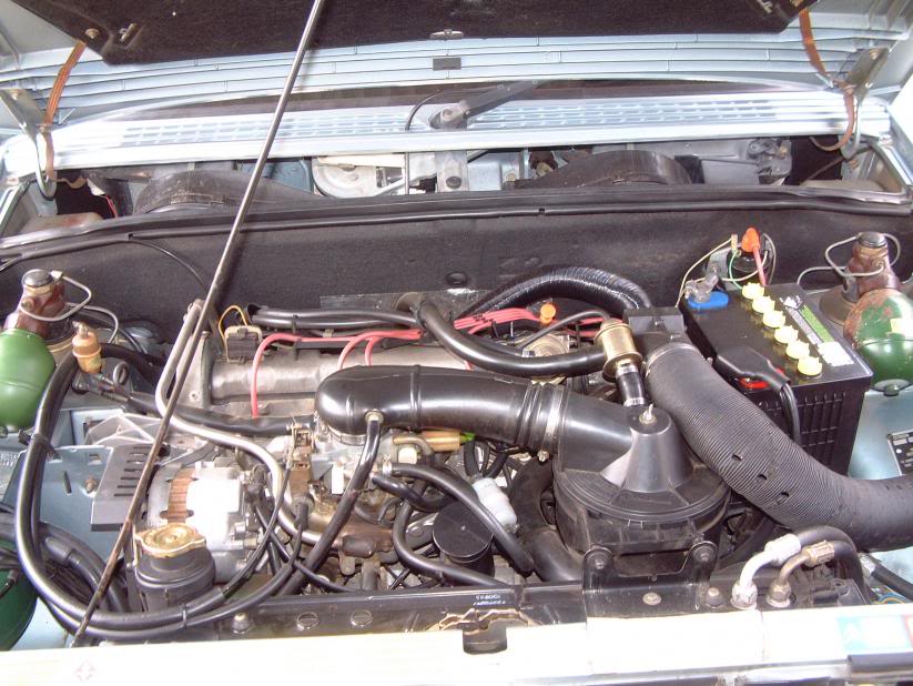

Thanks for your advice I will proceed with the carb conversion. Below you will see a picture of your new car that I copied from Aussiefrogs. Is this what the carburettor should look like post conversion?
I am glad that your pollution control system is still in tact as three of the small diameter hoses have become detached in my engine bay and your ability to be able to tell me where they go will be invaluable. I will post some photos later if you don't mind assisting me with this.
It would be nice to meet up if you have enough time while you are in Adelaide. I will PM you my details.
Dicky
Dicky
Re: its back!!!!..(if it had actually ever gone...)
Happy to assist where ever I can ...
Yes this layout on the TRS for the return is as it should be for a proper fuel return.. Drill only a hole size that would match the inner diameter of a return hose .. This ensure less chance of accidently mutilating the top of the carb as well as ensuring it wont leak..
After you have drilled the return port you'll need to fit a small length of outlet pipe, (the snugger the better)_ and then seal it in place with an application of some fuel and temp resistant gloop...I used Quik Steel which works very well...
Interesting the TRS appears as though this is its' original setup... Maybe the dreaded Tee piece mod was only for the GT..
This is a quick pick of my "mod" or should I say "un-mod"
