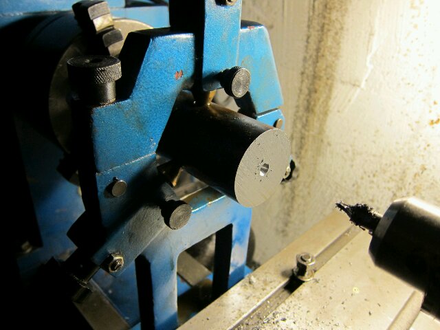

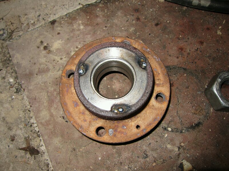

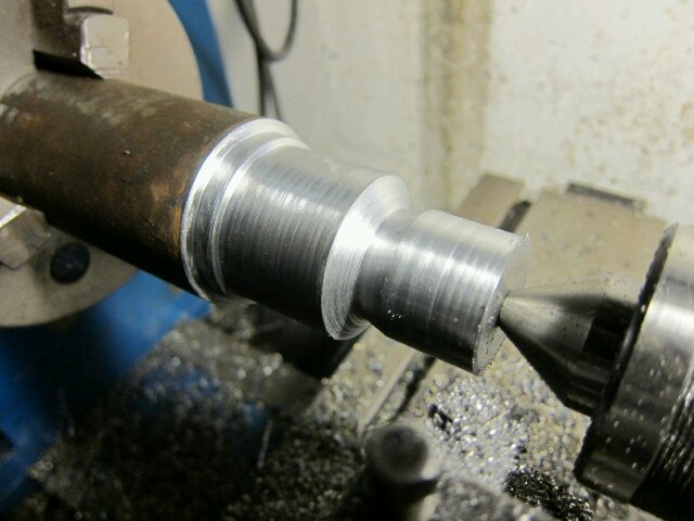

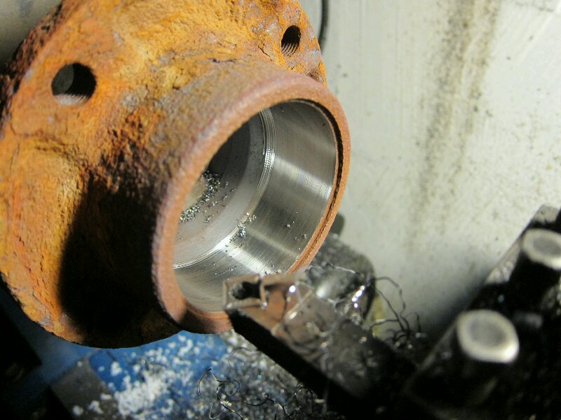

Was the blowtorch simply to soften the bearing race then, to make it machineable?
rmattila
Posts: 412
Location: Finland
Contact:
Post by rmattila »
Yes.

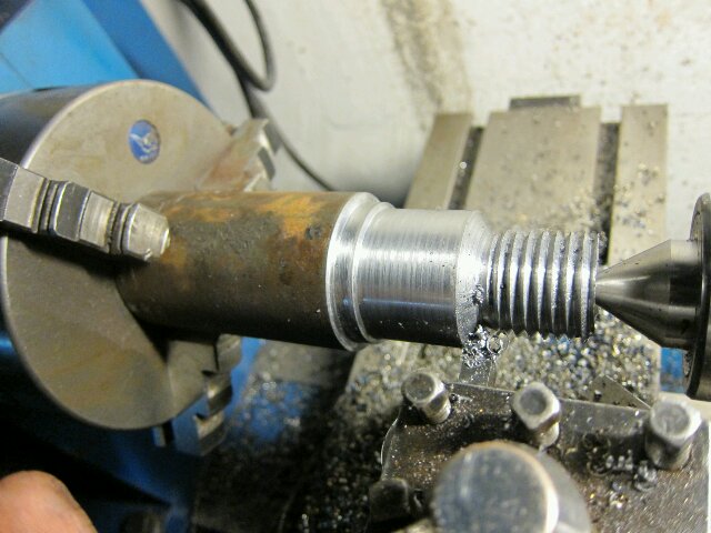

I've got a number of worn-out hubs on the shelf, and thought of trying to use a pair of them on the stationary engine project. Even though the yield strength might suffer a bit in the annealing process, the loads will be significantly smaller than in the automobile use, so I think it should work.
BX Van 1.9D -90 Gone.
BX Van 16S -90 For sale.
Posts: 5917
Why do you need to soften them, they'are not case hardened? They should be machinable without softening??
sdelasal
Posts: 511
Post by sdelasal »
Why can't you drift out the bearing from the road wheel side of the hub ?
I bet you just like playing with that 'weed burner' thing and showing off your lathe !
I'm jealous!
rmattila
Posts: 412
Location: Finland
Contact:
Post by rmattila »

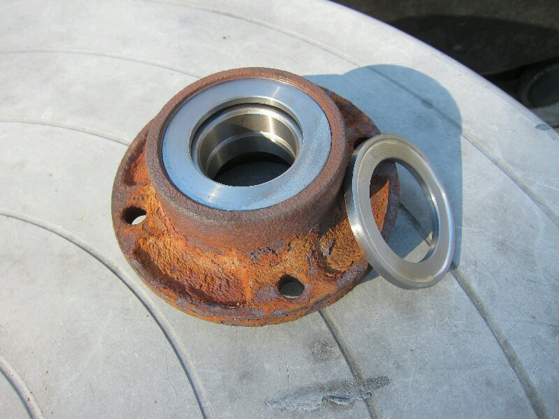

There may be differences in different brands. A least in those ones I checked, the races were directly machined into the hub material, and seemed to be hardened at least on the surfaces to the degree that I considered them un-machineable with regular bits. (Must admit that I didn't actually try, though..)
Posts: 5917
I thought you were turning out the hub but that is the actual race which is seperate to the hub and knocks out (and is hardened)
rmattila
Posts: 412
Location: Finland
Contact:
Post by rmattila »
Defender110 wrote:I thought you were turning out the hub but that is the actual race which is seperate to the hub and knocks out (and is hardened)
At least in that hub (as well as in a couple of others I checked), the outer race was not separate but machined directly into the hub, and that's the whole problem. Had to machine it out in order to be able to fit a separate bearing and not having to buy an entire hub. What they sell as "rear wheel bearing" at least over here is actually the entire hub assembly. Different thing with the front wheel bearings, which are more sensible design and do knock out.

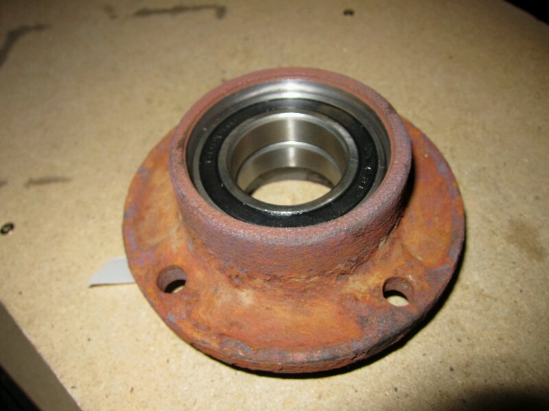

Two standard 40x68x15 bearings in place of the original integral one.
Posts: 5917
Nice to see a bit of good old fashioned engineering in this new throw away society. :wink:
