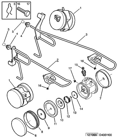

When I raised (hahaha) this issue in my blog thread I received this reply:
Gary wrote:Did you lubricate the bush on the sub frame that the height corrector linkage pivots on?
It is a bit difficult to see from underneath but i think you can see it on the o/s from under the bonnet on the petrol models behind the engine near the steering rack.
It is number 4 in this diagram

I will need to lubricate this linkage to the height corrector. Is this accessible at all from above or do I need garage/axle stands etc. ??

Just tried to find the right bit to lubricate from above. I could not find it. the diagram has good detail but I just could not see it. It may be time to buy some axle stands from Lidl.

I think the height corrector linkage you want to lubricate is the one above/behind the front subframe, not the linkage for the lever in the car. Basically your looking for part 7 (the height corrector) in the diagram, and the linkage near is what you want to lube. And yes, that other part will be the steering rack. Its actually one piston with two ends, one for each wheel. Can you reach in to get the gaitor back on? Some strong zip-ties might work?
