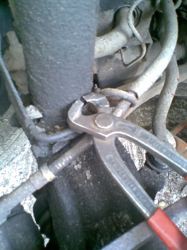

Re: leaking struts ?

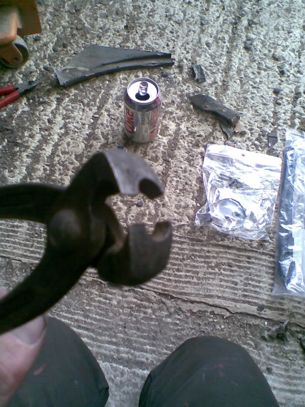

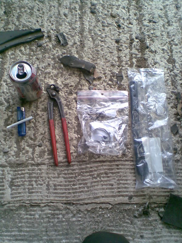

I use side cutters, like these:
But in fact you need some other tools aswell:
in order of importance, fag, lighter (for the fag), diet coke, side cutters, new clip and the new pipes!
In use:

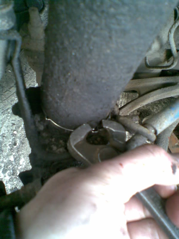

closing the clip:

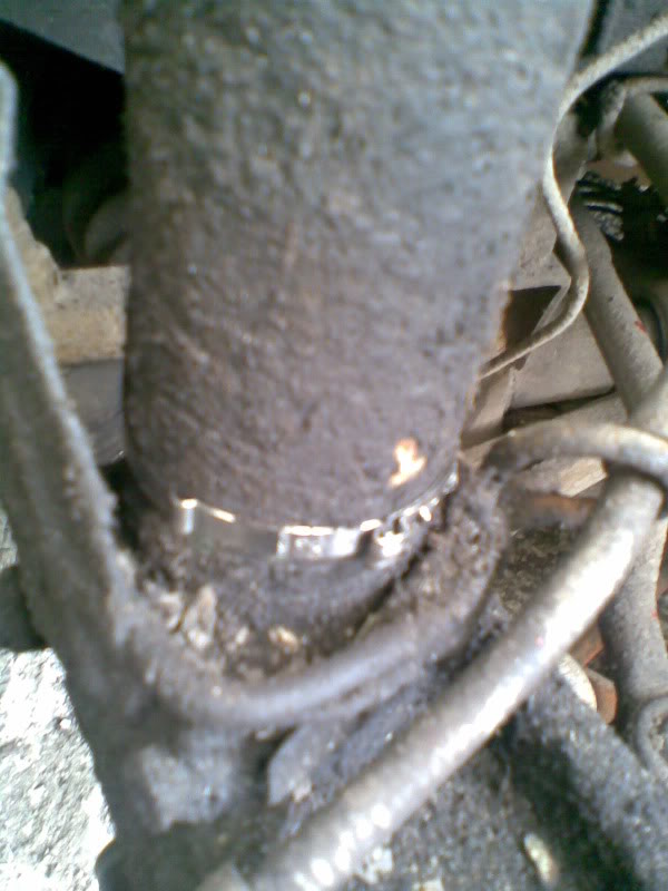

Job done:
Less than 1 minute a side.

Do you normally give the clip a slight tap with a hammer to ensure the lip section won't come undone through vibration?
