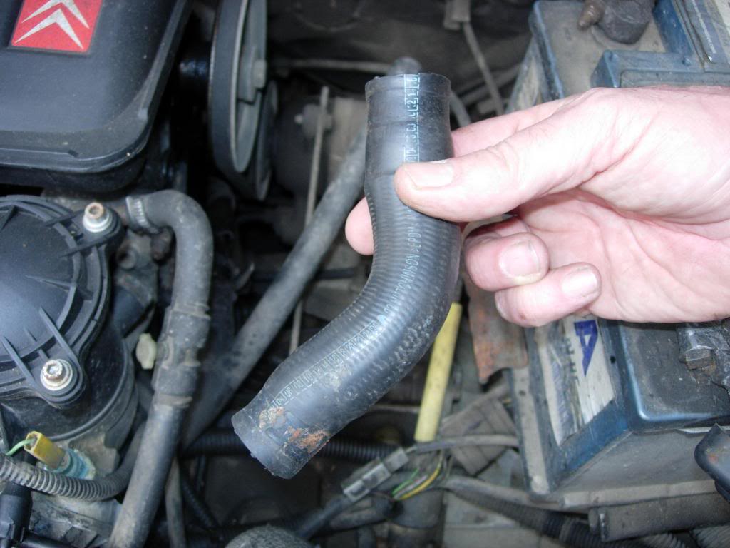

Re: water hose - can you name or number it?? Got a leak!
This is the pipe thats bust, pinkies included for free!!
more than likely the oil killed the hose, and yes it is the one i thought it were

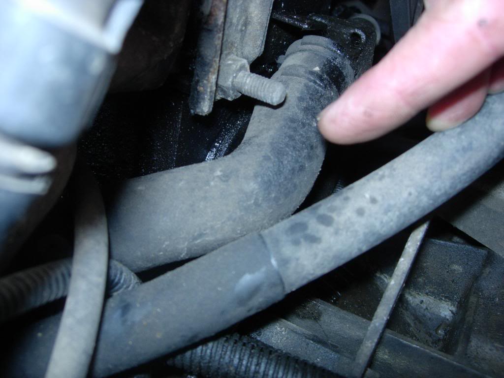

You can also see the water hose with the bleeder tit too.
Tell me Malcolm, would a piece of hose with the same diameter do and cut to length rather than try and find the right part?
Probably be a lot cheaper and easier to find. Whats the measurement Tim?

Than £6.74 from CitroenMothman wrote: Probably be a lot cheaper and easier to find. Whats the measurement Tim?
the prob with fitting say new section using the likes of heater hose, as its oly very short and has to curve you might find it collapses at the bend,
so for the price the dealer is asking its probably the best option

Thanks, Malcolm! We salvaged the scrappy lengths and used those, they will do for now. The oil leak is from behind the pump pulley (hence the 'fling', though not enough to make the belt slip). I assume this is the camshaft seal, which if you believe Haynes is a simple job. Any thoughts?
