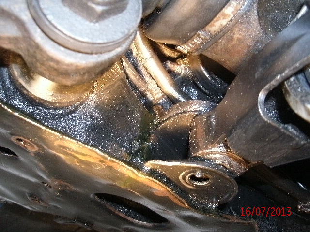

After recently fixing three LHM leaks, I am now faced with what looks like an octopus problem.
I have roughly located the leak, but at the moment cannot view the top of the rubber manifold to establish which of the 3 circuits is causing the problem.
I am looking for any clues, hints on how to find the leak so that I may be able to replace the faulty circuit only, As it looks like the complete octopus is not readily available.
I have removed the bolts from the stabilizer bar, but still can't get a small mirror over the top to give a view.
I am guessing it may require to remove the driveshaft, the front exhaust, to allow the engine to tilt forward and remove the stabilizer link and somehow drop the subframe a little.

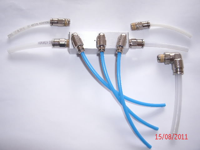

No, you don't need to remove driveshaft or remove subframe. Can I refer you to the current octopus discussion on the Chat section, you will guess what my suggestion would be!

Thanks Tim for the Chat section discussion link.
I have seen this article before, using brass fittings and rubber tube, brilliant write up.
There was also another thread showing fitting the manifold and pipes over the wing, but I can't find it.
Interesting and valuable thread this, hope we get some more input, if so would be worth saving as a sticky.

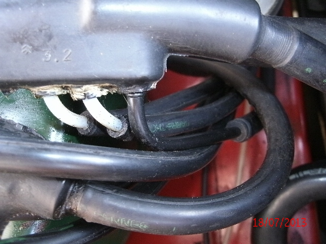

I had thought of doing this to the small octopus in the picture below, but in the end did a quick fix as shown and is holding up well.
I think the repair / replacement will be a more complex on the TD, due to the additional pipes etc.
