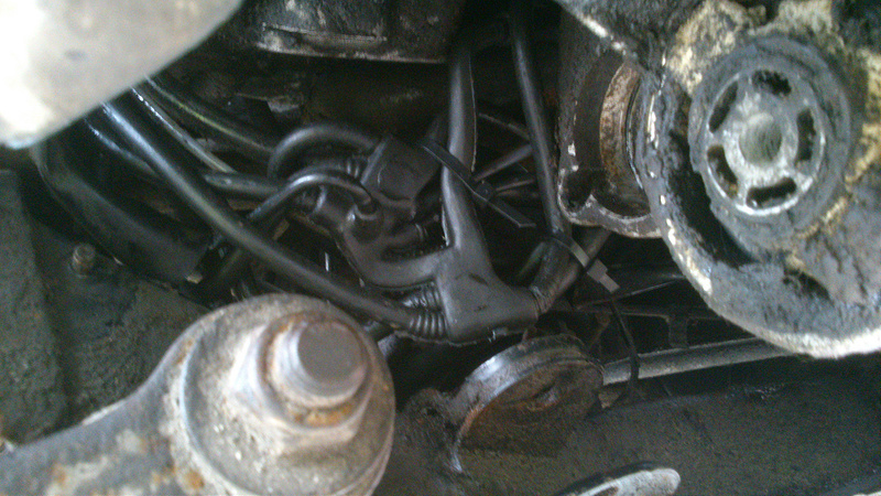

We removed the O/S shaft and bearing

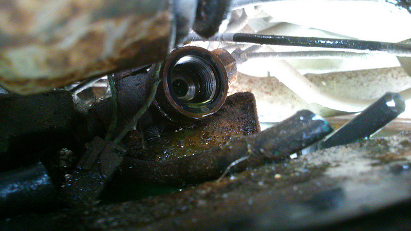

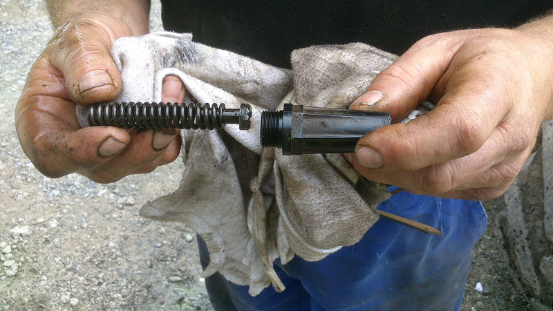

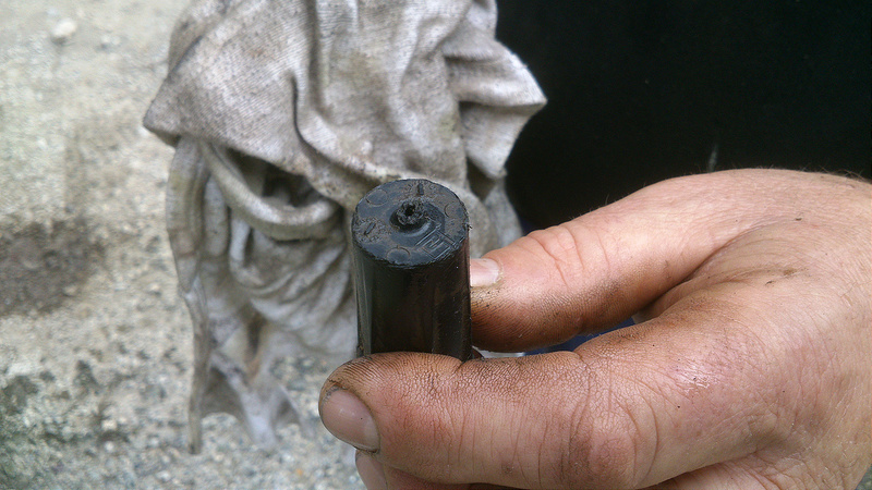

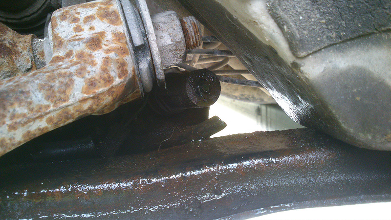

But then we discovered another leak today, from the N/S, behind the gearbox near the subframe

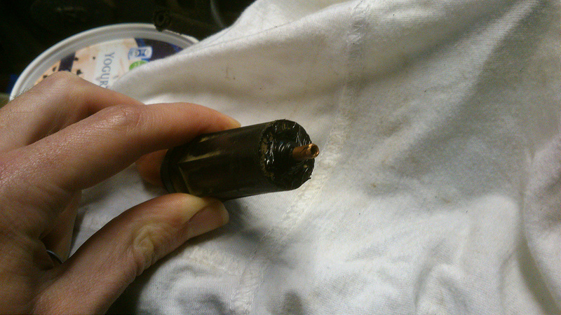

When trying the remove the perished pipe (resting on subframe in the pic) from the little unit (above it), we broke it
When we unsrewed the little unit (it spung off), we were greeted by a spring and a gushing waterfall of LHM...
Behind the unit, it joins into steel pipes and there's wires there too.
What is this unit and where I find another? Or whats the best repair?

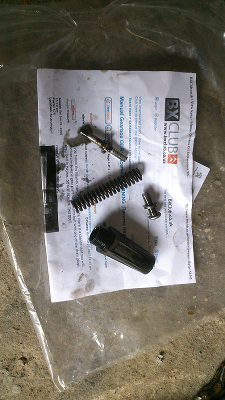

its the safety/priority valve
here is price and part No.'s from service citroen
this is the complete unit
96151895 SAFETY VALVE 90.58 GBP 108.70 GBP 108.70 GBP
this part is the end cap your spout broke off from, it is NFP from the dealer now though
96049204 VALVE PLUG 1.37 GBP 1.64 GBP 1.64 GBP

Hi Kieran, As already stated /\ by Malcolm its the 'Safety Valve' !kieran.l wrote:...........................................
Thanks.
Its a shame you never posted up your problem/want a week or so ago as the /\ NOS sold on E-bay (19/09/13) for only £5:00 and that was after the seller previously got no bids on it for £10:00
Good luck in finding one or hopefully someone may come forward with an offer of a good S/H one ?

You must be able to fix a nipple of some kind on your cap to allow it to still be used, It is only low volume / pressure return. How about gluing a tube support like on of these into it after drilling out to the right size?

I wonder if it would be feasible (subject to the internal bore of the Rubber tapered/cone cap) to adapt something like a 'Presta' valve from an old cycle inner tube (Having disregarded the internal valve assy.) so that you have an internal flange feature which locates and seals it self internally and is fastened/secured externally by the larger threaded diameter (But also use a plain washer under the nut/collar)Defender110 wrote:You must be able to fix a nipple of some kind on your cap to allow it to still be used, It is only low volume / pressure return. How about gluing a tube support like on of these into it after drilling out to the right size?
http://www.ebay.co.uk/itm/Nylon-Polyure ... 3f21666eeb" onclick="window.open(this.href);return false;
As the reduced threaded dia. already has a similar undercut/neck feature (Similar to the original moulded end of the rubber cap) that's severed off the end of the Safety valve !
I would say that the outlet of Rubber cap would also need opening out a little to take the 'Presta' valve, also check FIRST to see if there's enough distance/clearance between the rubber cap end and the box section/chassis as that's fairly close and the 'Presta' valve shaft is fairly long !

i think the end cap is plastic not rubber,
and im sure you can affect a repair but not with a tyre valve,
i would just line the original broken off spout with a short length of metal/copper pipe,
and bond it in place with the likes of
http://www.tesco.com/direct/5-minute-ep ... tAodWT4AZA" onclick="window.open(this.href);return false;

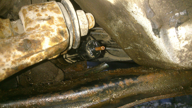

Thanks for the suggestions guys As it turns out, my father fixed it similarly to that suggested by Defender110 where he drilled it and placed a small copper pipe in it and sealed it with tiger seal.
It seems to be doing the job, and no other leaks either.

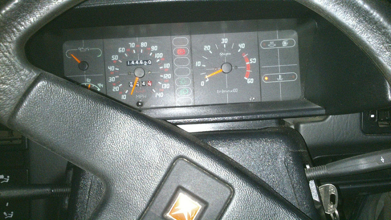

A couple of things though - the temp light is on constantly from start up (the water level is holding). We measured the engine temp using a lazer sensor gun having driven her and the temp on the thermostat housing was about 85C, so we don't think she's overheating.
Also, even though the main beams were working for a while, now they aren't - and there is no main beam blue light coming on the dash either??
The inside fan is completely dead too.
And she doesn't go to high at the front, but only at the back when selected and the height level is as stiff as hell, almost impossible to move out of driving height.
