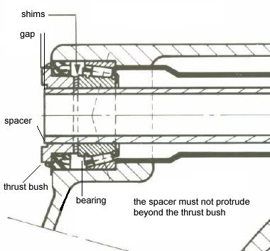

Citroen Workshop manual xb 433-2 which deals with the replacement of rear arm bushes and the corect method for reshimming can now be found in the downloads section of the BX Project
And also at the following direct link
http://www.bxproject...SNIP.../XB422-3RearArmBearing.pdf
This follows on from a sub discussion in toms post about TZD Restoration in the 'Chat' area

It looks like the tool is actually used to measure the distance between the outer faces of the mounted bushes so that shims can be used to adjust this width to ensure that the metal spacer length is just shorter than the bush face to face distance, and so does not protrude beyond the bush faces. This makes sense now. The specified torque on the 24mm nut of 13 kgf m is converted to thrust and transmitted through the subframe to the thrust bushes to establish the preload on the bearings. If the spacer protruded beyond the outer surface of the bushes, it would but against the subframe and interfere with the transmission of this thrust. Sufficient shims are added to ensure that the spacer is just shorter than the bush face distance by a fraction of a millimeter.
A picture paints a thousand words. Thanks again Vanny.
