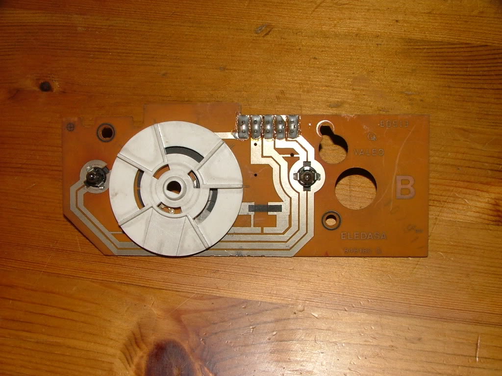

The ELEDASA board had a design fault and somewhere on this site is the necessary info to mod it in order to allow the fan to run at full speed.I'll see if I can remember where it is.
Posts: 6417
x 88
Contact:
Its easy.....on the front of the board there are lots of metallic strips, and the one closest to the dial has a little dark coloured panel between two of the contacts. Flip the PCB over and solder a wire between the two, bridging the little panel type chap in the process.

NO! That is not it. I'll just have to find the correct posting...
http://www.frenchcarforum.co.uk/forum/v ... php?t=6133
This is quite a long thread but the data is about half way down page 2 posted by one Tomsheppard. The web reference no longer exists but the pictures were uploaded to a scandinavian site some time ago so if you really need a picture, googleit up.

See the drill hole that breaks the track between the 3rd and 4th pins (counting from right to left) ... as I see it this is the one to bridge ...
The little black panel looks like a thick film ... don't bridge that one...
damned if I can fine the Scandinavian website ....

Post by tom »
NO!
Link the gap in the track fourth from bottom beneath the black resistive track, then cut the thin vertical track below the left hand side of the black resistive track.
Thanks for the picture Doz!
Would earlier posters on this thread please amend their erroneous posts and then the mods could make this one a sticky if they feel so inclined.

Tom's right - worked well on mine and I found the full fan speed complete with relay above the steering column which worked despite about 15 years of idleness!
While you've got it apart it may be worth cleaning the contacts on the rheostat wiper and making sure its got enough tension.

When I get home tonight I'll mod the picture and post it up, then we hav the definative mod...

Post by Doz »
So I think this is it then...
