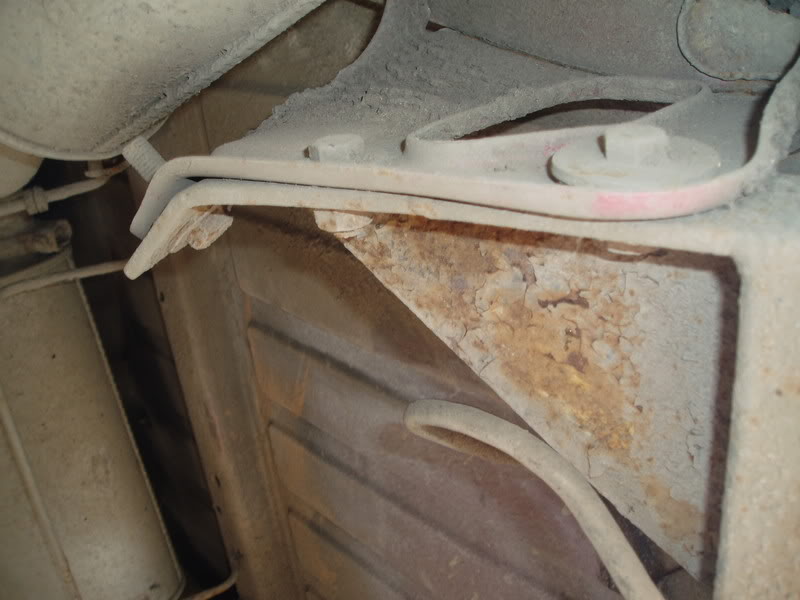

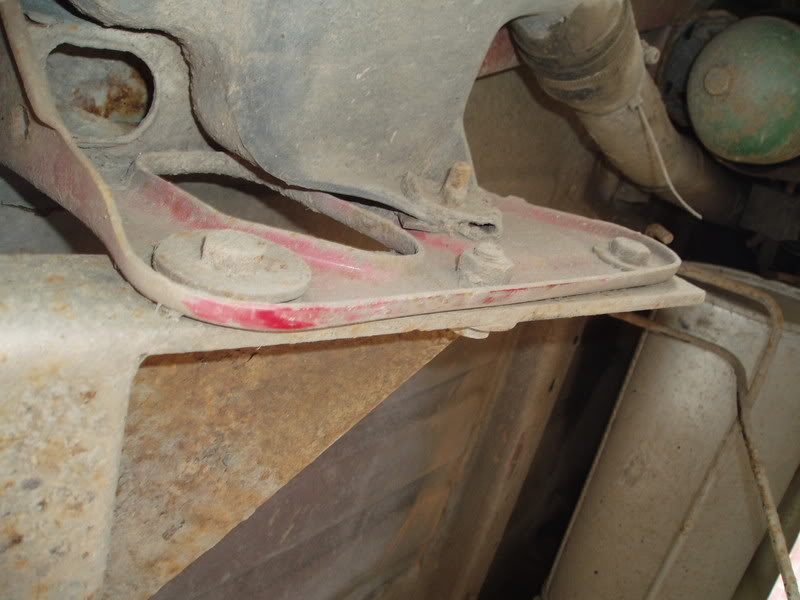

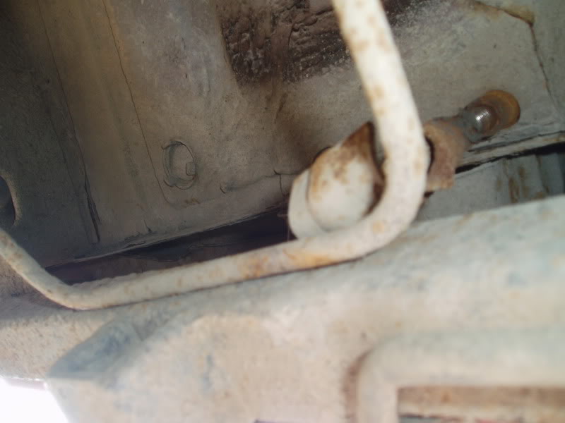

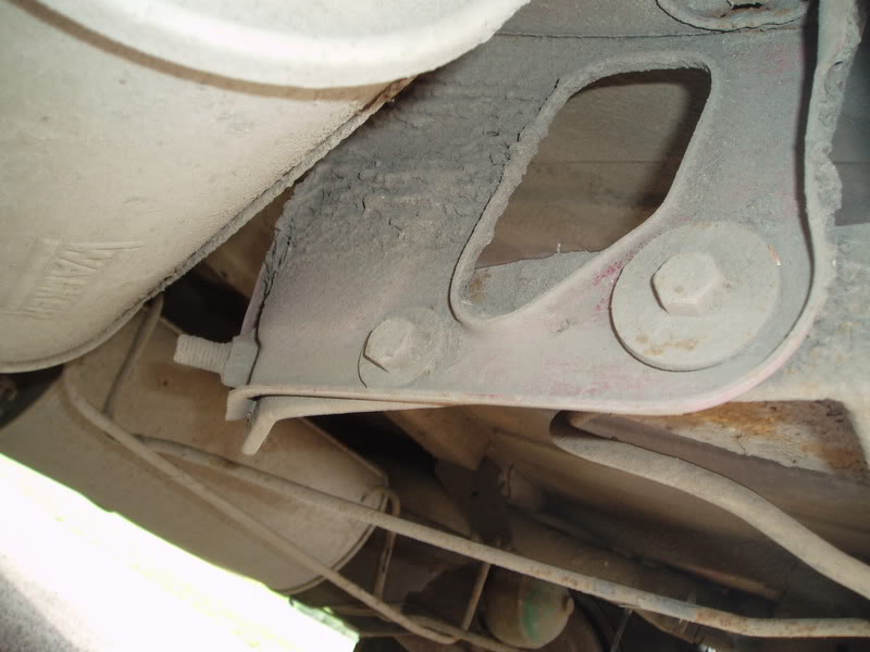

Hopefully, the following will help WannaBx.
Above is n/s fitting...
Spare wheel carrier just fits...
n/s again
o/s
M12 bolts should be ok. From memory, this may of been a homemade towbar but came off a Mk 1 BX. I had some extra plates welded on to give extra bolting locations.
