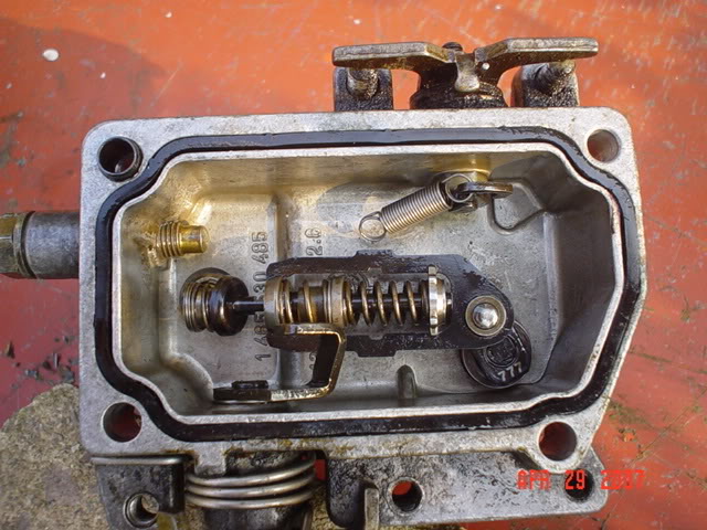

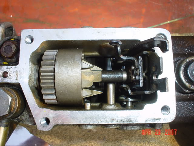

Hi Mark,
I have renewed the shaft O ring on a N/A Bosh pump, this may be similar to the Turbo one. Pictures below that may help.
In fact I have another pump in pieces at the moment, pics taken from this one.
Good luck...
You have to locate the slot in the shaft, just to the right of the black cup washer, into the slot in the black plate to the extreem right of the piture below.
Then hook the other end of the spring into the hook as shown in the top of the picture below. Also the end of the max fuel screw on the to left must push against the the lever shown top right in the picture below.
(It makes the task much easier if the max fuel screw is removed first, but ensure the position is marked to enable the same postion on reasembly).
Also note the ferrule to the fixing bolt, top left, which must locate in the appropriate hole, top right bottom picture..
It's quite a tricky job, but like all things, once done becomes a lot easier.
I would not attempt the job insitu, remove the pump first and secure in a vice or similar, make up some hooked wire to locate the spring, and use good lighting.
Good luck...
Good luck...
Good luck...
