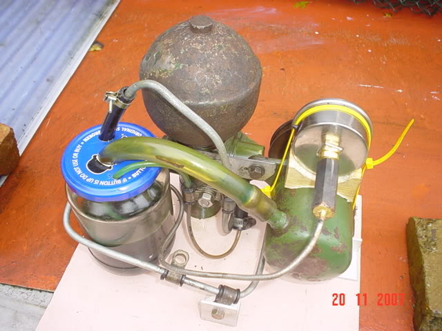

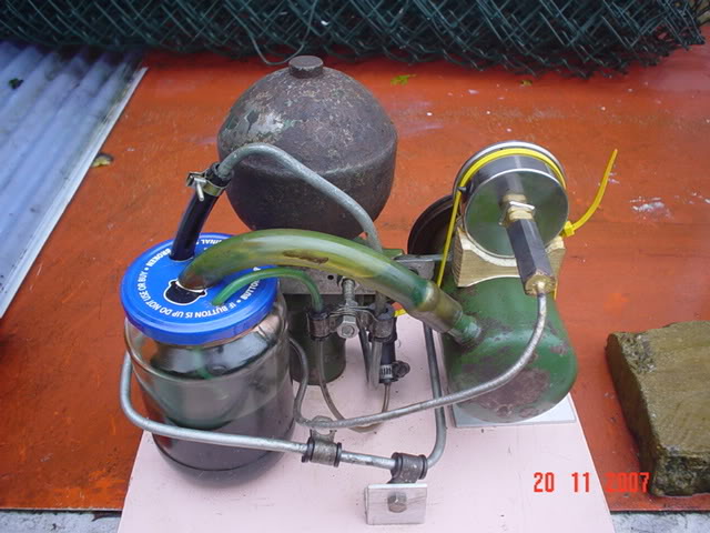

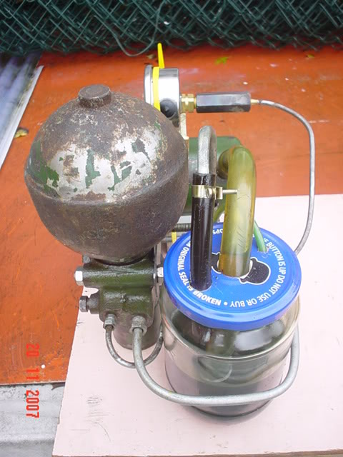

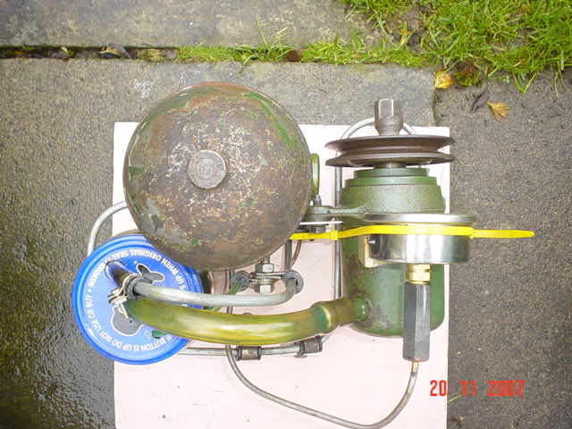

Hi David,
No, I did not have any other photo's, but have just taken some more as shown below.
This little project was a result of a thread on the FC Forum, when it's back on line, may be worth doing a search.
All the bits I had, with the exception of the gauge. This was purchased on the bay, and the connector to the gauge, which I had to get turned up by a small hydraulic machine shop.
Since using the unit, I found it is in fact dual purpose, not only can you test the sphere internal pressures, but also use it to test the function of each piston output of the pump, thus determine any variations.
Open the valve, rotate the pump to bleed all the air out, then close the valve, and with a spanner on the pump shaft, move clock and anti clock on the selected piston, count the number of compressions to reach a pre determined pressure on the gauge. Repeat on all pistons, then compare the results.
Hope this is helpfull.
By the way, you are only allowed one guess for the make of the LHM tank..
If there is sufficient interest, may be a good idea to make a sticky with it.
