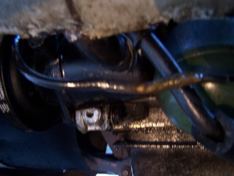

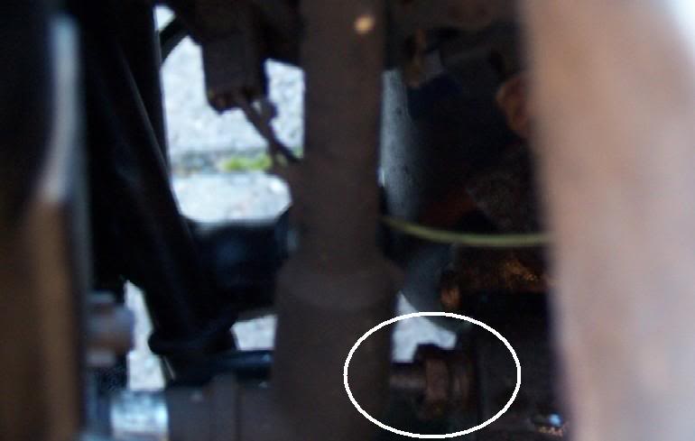

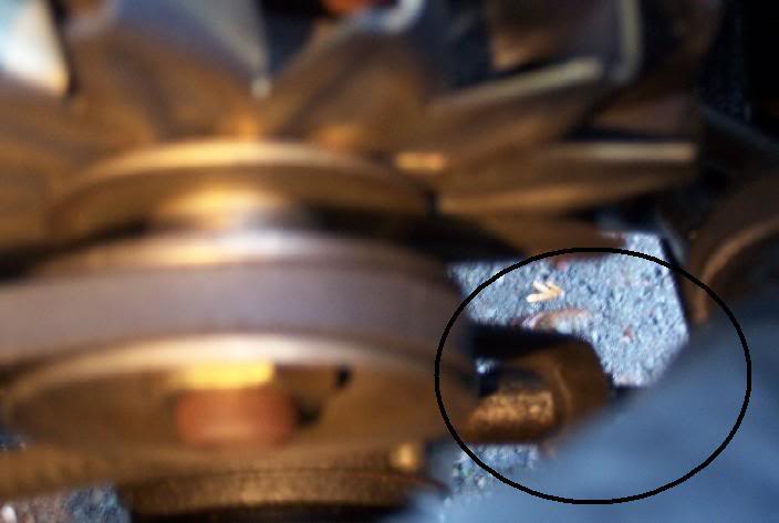

Not having much joy from my local Citroen dealer. They're doing their best but it is a bit outside their field of expertise. Not easy to get a clear shot because it is at the bottom of the engine. Anyway maybe these pictures will help:
It comes out of the HP pump:
Loops under the other pipes:
And goes into the pressure regulator (I think this is it):
I did my best to measure the length of pipe, it is about 475mm long to between the ends of the fittings.
It screws in with 11mm nuts (not 10 or 12 or any size I've got in a spanner).

That is indeed the High Pressure line between the pump and pressure regulator. It looks as though you will need to get the part number/or Plaides length for a non- power assisted car as its a St Tropez.
Amazingly, a previous owner had welded up holes in this pipe It looked to me as though they never put it back correctly, it dangled too low, and got hit by a kerb or branch, spitting the pipe where it goes into the HP pump union connection.
