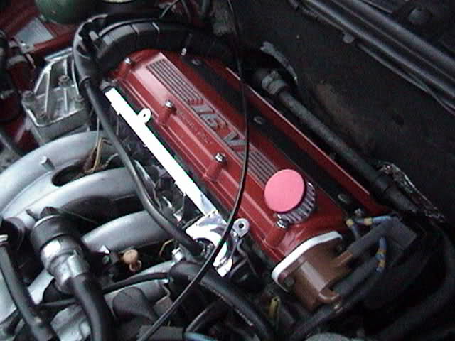

OK, can anyone recommend good leads. I have a new dizzy etc. and the coil's fine.
I am trying to get the engine as much 'on song' as I can, as I think it's a bit out of sorts... I'm running it with 99 octane fuel, all the filters are new and the battery is fine. There's just a hint of rough/inconsistent running at high revs, and before I go much further I might as well do the ignition side of things... can't do any harm I guess.

I pay £5.49 for a full set of the NGK's in Halfords, and have a set of BOSCH leads which where special order from Halfords for £40.00 fancy silicone jobies and they made a noticable improvement over the semi brittle ones that where on the car at the time.
Starting to think there might be enough people about to get an order into Magnecore, needs 10 people or so to order

Needless to say my valver sports a full set of Magnecore leads, they're the dogs b*ll*ocks, they really are.
You cant beat a nice fat spark.

8) Magnecore leads all the way!. I have the electro sports on my 16v ( blue leads) they are about 4 or 5 years old now and have never ever given me any trouble. We run magnecore kv85 leads on the green 16v ( red leads) and theyre fine too.

8mm Electro sports are £61.18 all in. KV85's are only about a tenner more, but I imagine they wouldn't fit under the cover.
I think I'll consider the former next month.
