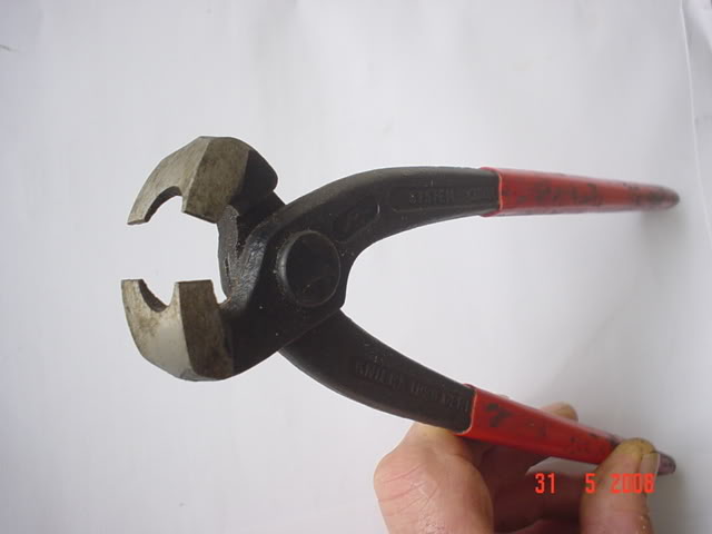

But the tool that I use is shown below, you can also use a carpenters nail remover type pliers, or modify a pair of pliers, just grind sharp edges on the jaws.
Good Luck
http://www.frenchcarforum.co.uk/forum/v ... php?t=8627
Good Luck

Thanks for the advice, will look round for a pair of what we used to call pincers!

Hands aren't as strong as they used to be, so thought there might be a tool with plenty of leverage which gripped the bits that stick out on the sides, presumably they are there to help pull the clip round the strut.
Well as Brian said cobblers tools!!! Even simple jobs have a way of taking toolong.
