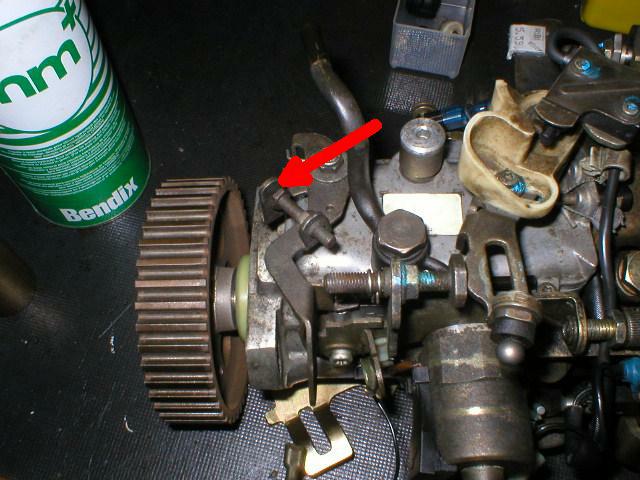

All pups have an emergency stop lever just for occasions like this:
On the Lucas/RotoDiese/CAV it's on the fast-idle lever appearing as a raised tab. below it will be an arrow and the word "STOP" Push this tab toward the cambelt and the desired effect will happen. Effectively, the lever just lowers the idle speed tto near zero and the engine stops.
On the Bosch, the Emergency Stop lever is on the front face of the pump (as you look at it, peering under the bonnet) and apepars as a vertical lever. Push it and the engine will stop. Off-hand, I'm not sure which way but if you push it one way with no effect, try the other.
It's not a bad idea to familiarise yourself with the emergency stop lever before you find you might need it in anger.
I'll pop up some photos of the two levers when I get home if that'll help.

This is the Lucas Emergency Stop lever. Push it in the direction of the arrow away from the idle speed adjuster screw head.

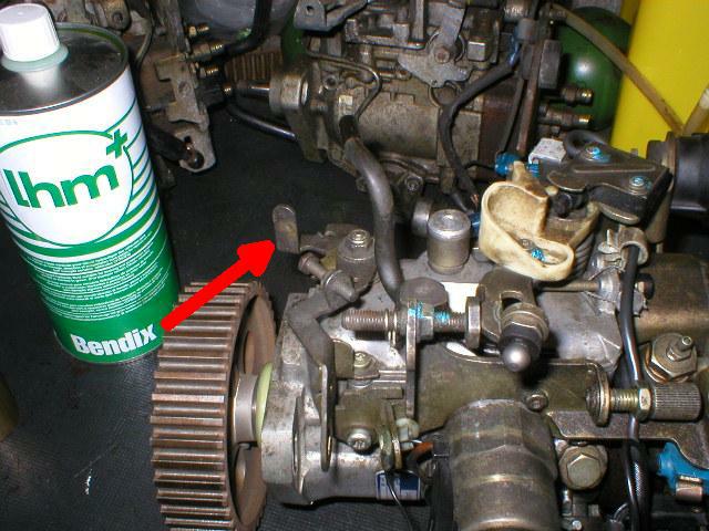

This is the Lucas with the lever operated to the Stop position.
