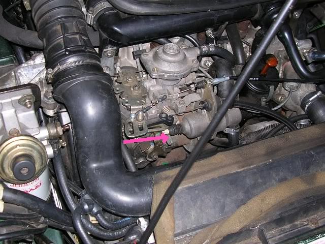

The 24/7 thread was very informative, but I couldn't relate the pictures to my pump. It looks like this:
Whereabouts should I be looking for the solenoid and stop lever?
Many thanks, Trevor
I had suspected the solenoid but couldn't find it. Even looking for the wire turned up empty. Maybe that's the problem, the wire has simply fallen off.

Oh joy! the stop solenoid is situated on the right hand end of the pump, well buried from view on these Bosch pumps
Not sure where the stop lever is on these, usually around the accelerator lever, but wouldn't swear to this without checking.
It's so unusual for these pumps to fail and not being so easy to get at, I'd be checking the fuel supply for air first.

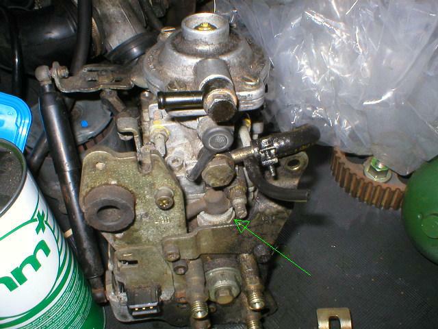

Ahh, that's the special pump for an automatic, us Poms don't see too many of those It has a torque control.
The stop solenoid is well buried Ken. I hope this picture will help. I've removed the engine for clarity in this shot. The green arrow points to the stop solenoid. Note that the electrical connection is protected/hidden by a rubber cap.
Sorry for the quality of this picture. It's an old pump on my workbench...
Later Bosch pumps were armoured in the region of the stop solenoid to deter theft by hotwiring. If yours has armour, it's a pump-off job to get at it althoug they did not fit this until late 1996 in the UK so I'd be surprised if yours has it.
In yours, the solenoid will be well hidden by the big vacuum pipe going to (I assume the crusise control) vacuum actuator.
The emergency stop lever should be in a similar place but will lokk a bit different. In your picture, look at where the throttle cable joins on the black plastic link rod and you'll see a coil spring behind it. That is where the lever should be.
Hope after all that, it is the stop solenoid playing up

Thanks for the pic. My car is ex-UK, the diesels were never imported here. Brian brought it over in 1997. Strange that they would put an auto pump on it, it's a manual turbo. Still, I've not come to expect consistency.citrojim wrote:Ahh, that's the special pump for an automatic, us Poms don't see too many of those It has a torque control.

Do what now? There never was a factory auto TD. There were alterations made to the 1.9D auto pump to add the kickdown cable, but this isn't one of them. Certainly looks identical to my 1.7TD pump. Presumably that is a cruise control cable on it?citrojim wrote:Ahh, that's the special pump for an automatic,
The stop solenoid has already been highlighted. Your mechanical stop lever is here:
And you push it in the direction of the arrow to stop the engine.
If the solenoid checks out ok, the next thing I would do is crack the injector lines off at the injectors, and then crank the engine over. Fuel should spit out of the injector lines. If it doesn't, then you need to check that the injection pump is getting fuel from the tank. Remove the return line, turn on the ingnition and pump the primer. Does fuel come out of the return on the pump?
If you've been running on Diesel fuel only (and not any form of "alternative" fuel) I'd be very surprised if the pump is damaged.

Thanks David I took a bit of a guess at it being an auto pump...
The thing above the pink arrow with the two pipes on it is the cold-start advance system (KSB) and not a vacuum actuator at all. So be careful with those hoses; they're full of coolant!

Is this not an Auto TD then David, or is it a 1.9D Auto?
Sorry for the errors

The extra cable is indeed for the cruise control. It's run pure diesel 99% of its life. I've put a few tanks of b20 in it, that's mineral diesel with up to 20% biodiesel added. Hardly a threat, I would hope.
The mechanic did confirm that fuel is getting to the pump. We loosened the bleed screws and there appeared to be no lack of supply while cranking it over. It wasn't possible to check for air getting in, though.

Thats a 19N/A mate.citrojim wrote:Is this not an Auto TD then David, or is it a 1.9D Auto?
There was never a factory built 19TD, although several do now exist.
AFAIK there is only 1 TD auto BX in existence, and that wasn't factory either..

That's a 1.9D auto.citrojim wrote:Is this not an Auto TD then David, or is it a 1.9D Auto?
The only diesel autos from factory were the 65hp square-port and the 71hp oval port 1.9D units. The later unit is only painfully slow; the earlier one is agonisingly slow.
I keep mentioning "from factory" as DocChevron has built a TD auto, but that needed a completely unique box being built for the application. AFAIK it's the only one in existence.
