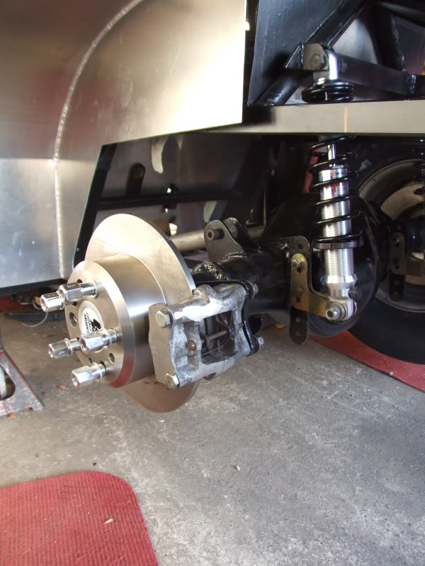

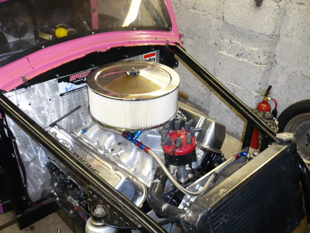

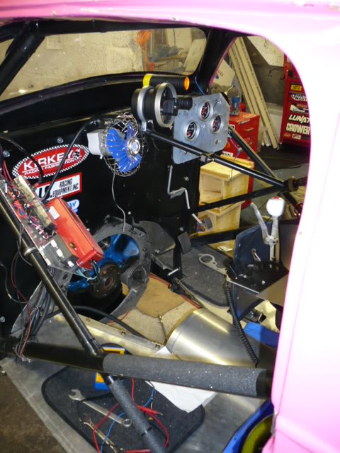

heres a few pics, as for the fluid, its just regluar 'cheap' motor factors brake fluid! is that a problem?
Here is the only pic of the brake set up.

Wowzers! You either love or that sort of thing (and I can\'t make my mind up!)
I actually think you\'ve used BX calipers - the two pedigrees are at odds!
Was there any reason you used BX calipers?
erm......your seals won\'t last very long using brake fluid! You need green blood (LHM)!!!!!!!
