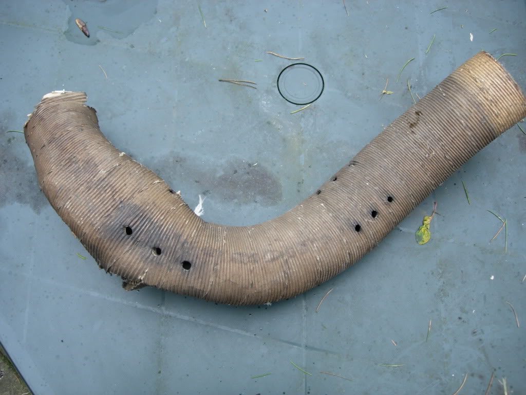

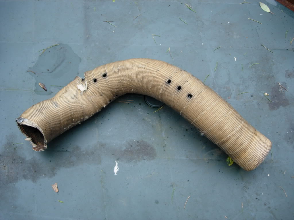

Anyone got one of these, the air tube for a MK 1 Diesel. Runs from a hole in the bulkhead to the airfilter. Mollie's is knackered, most of the internal foam was in her airbox which has all now been cleaned and filter replaced.If this is made from unobtanium, any suggestions for a replacement that will work?

It seems that the foam inside the tube turns to dust and collects inside the air filter housing causing a right horrible mess inside. Ime kicking myself for not buying on feebay the bit of kit Ian mentioned but there you are, it might surface again sometime.
