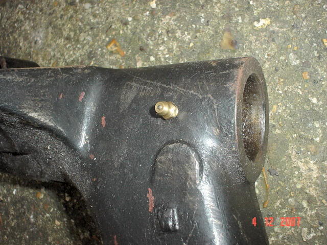

Interested in the method of plugging the void, what material have you used, and how was it held in place?. Expandafoam springs to mind.
There is a method of luricating the rear arm bearings in-situ, and it is worth doing if they are in good condition. I think it was Bob Smith who produced the thread, but I can't seem to locate it at the moment.
Anyway, this is one that has the grease nipple fitted, waiting for the bearings etc.
The distance from the edge of the arm to the nipple should be 30mm +/- 1mm.

Ah! there is a different approach being taken by two different people here.
The plastic tube separates the bearings from the rest of the void of the trailing arm. You can either cut a hole in this plastic, and fill the entire arm with grease/oil, or if you fit the grease nipple where shown in the photo above, you can introduce grease/oil directly into the bearings, with the plastic tube intact and preventing the grease from filling the void.
In theory, if you were to pump enough grease into one end bearing, it would travel along between the plastic tube and the steel spacer tube, and eventually end up in the other end bearing, but I would think it's easier just to fit another grease nipple for the other bearing.
Either way, it's got to be far better than the original setup where once the bearing goes dry it's scrap.

All that will achieve is introducing grease between the bolt and the steel spacing sleeve. For this to work you would need to drill a hole in the spacer sleeve too, and then accurately line the hole in the bolt and the hole in the sleeve up when you assemble it all. Not easy at all. Plus there's the issue of weakening the bolt somewhat.
IMO the ideal solution is the picture that you posted above, with the grease nipple introducing grease between the outer race of the bearing and the oil seal. That way you need minimum grease for maximum effect, especially if there is one grease nipple at each end. Plus you should be able to install these in situ (although I have to say I'd rather remove the arm, fit new bearings and then grease them, as you may simply be greasing knackered bearings.)
Edit: Actually, the more I look at the picture you've posted, the more I wonder where it is introducing grease to. I would expect it to be more like 10-12mm from the end, so that you introduce grease just behind the oil seal, directly into the bearing race.....

Post by Brian » Wed Dec 05, 2007 7:41 pm
Options are open to where you drill to introduce the oil/grease. One at each end would be preferable, but you have to be carefull to ensure you can get the grease gun to nipple.
30mm from the edge is bang in the middle of the smallest diameter section that the plastic tube is located.
I have used this position, as it was in the original thread, also you only need to install one nipple, as the oil/grease mix used is very fluid, and will then run to the inner bearing during use.
