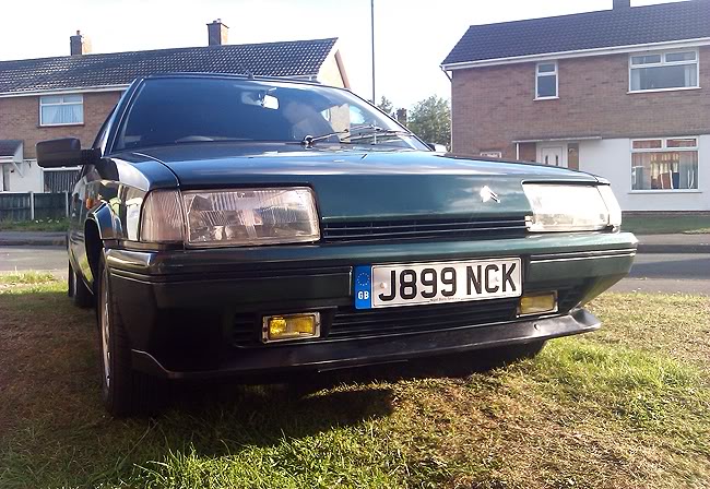

Ta dah . . ! My new foglights . . .
. . . and the repair to my rusty rear door shut. :shock:
I replaced my non original (but not entirely inappropriate) foglights today, with some long awaited proper ones (courtesy of KevR) I think they look rather nice and I'll now be able to get a good nights sleep :D Unfortunately the splitter had been drilled to accept the old lights but I managed to get some trim . . . er trimmers from a motor factors that fit very snuggly and look the part (I think)

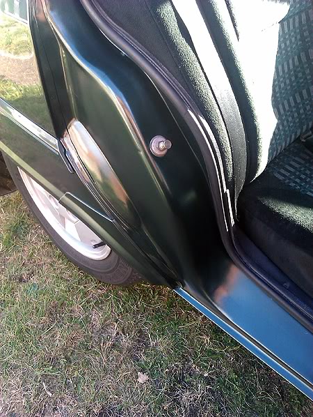

I also finished the lacquering of my repair to the rear door shut which I've been trying to get done before the bad weather gets here. There's no blistering or bleeding through after a couple of weeks so fingers crossed! Just need to wait a couple more weeks to polish the lacquer and it should look luvlee! Here's my car parked in my spacious and well equipped workshop . . .

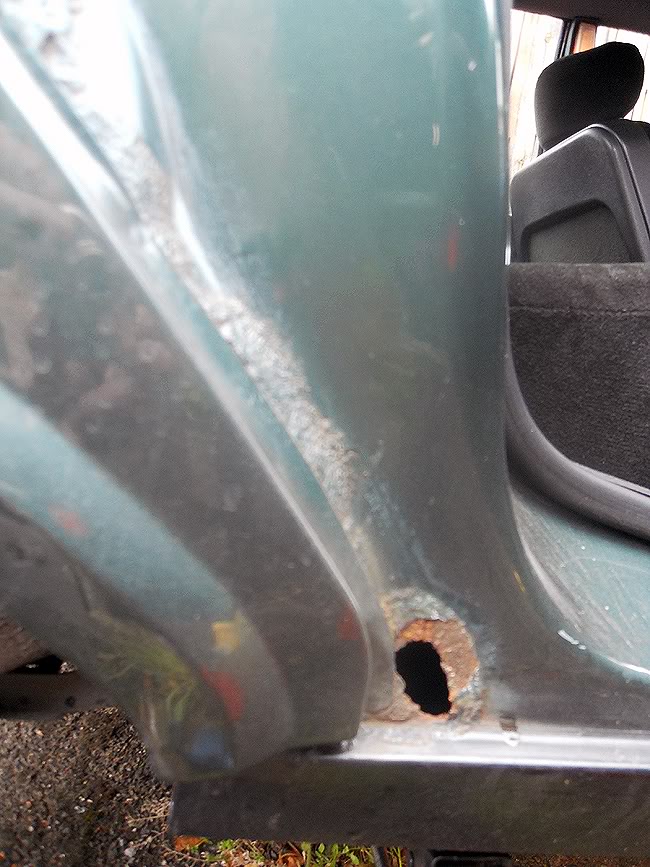

Before
After

I jacked up the car, removed the rear wheel and cleaned out the rear wheel arch first (which was pretty clean) then treated it with 'Kurust', painted it with Hammerite and coated it in waxoyl ( belt and braces is good when it comes to rust!)
Then all the rust in the door shut was ground off with a dremel multitool and the hole bridged with car body mesh. The filling was done with Isopon two part car filler fibreglass stuff (they sell it in motor factors). I applied it in successive layers with lots of sanding and refilling until I had as perfect a finish as I could get.

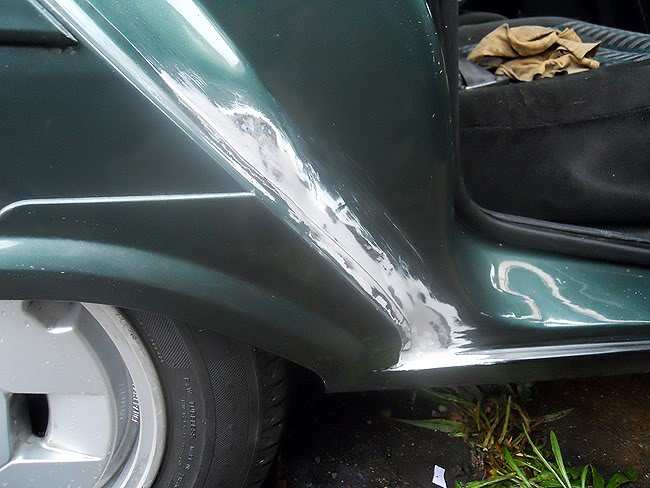

All the rust removed and sanded (it was then treated with 'Kurust')

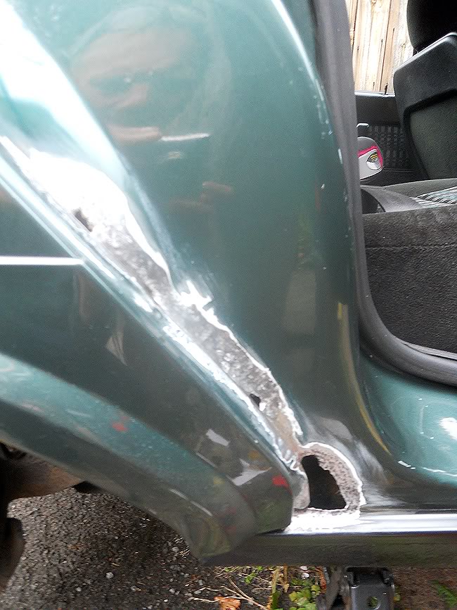

The filling finished (until you prime it and find it's not as good as you thought! - then MORE sanding) I painted the repair with motor oil - to protect it then left it for a couple of weeks to see if the rust returned - my experience is that if it's going to return it does so pretty quickly - usually overnight.

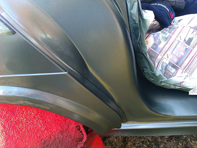

The final primer coat which was sanded into the old paint with 800 grit (if you use a high build primer it will get rid of some imperfections - but don't rely on it) Also, when sanding the primer be very careful on leading edges as you'll quickly sand back to the metal and have to start again!
The paint coat before it was matted back with 1200 grit. I repainted the whole of the rear wheel arch so that the new paint could be keyed into the old paint and it was pretty scratched anyway!
