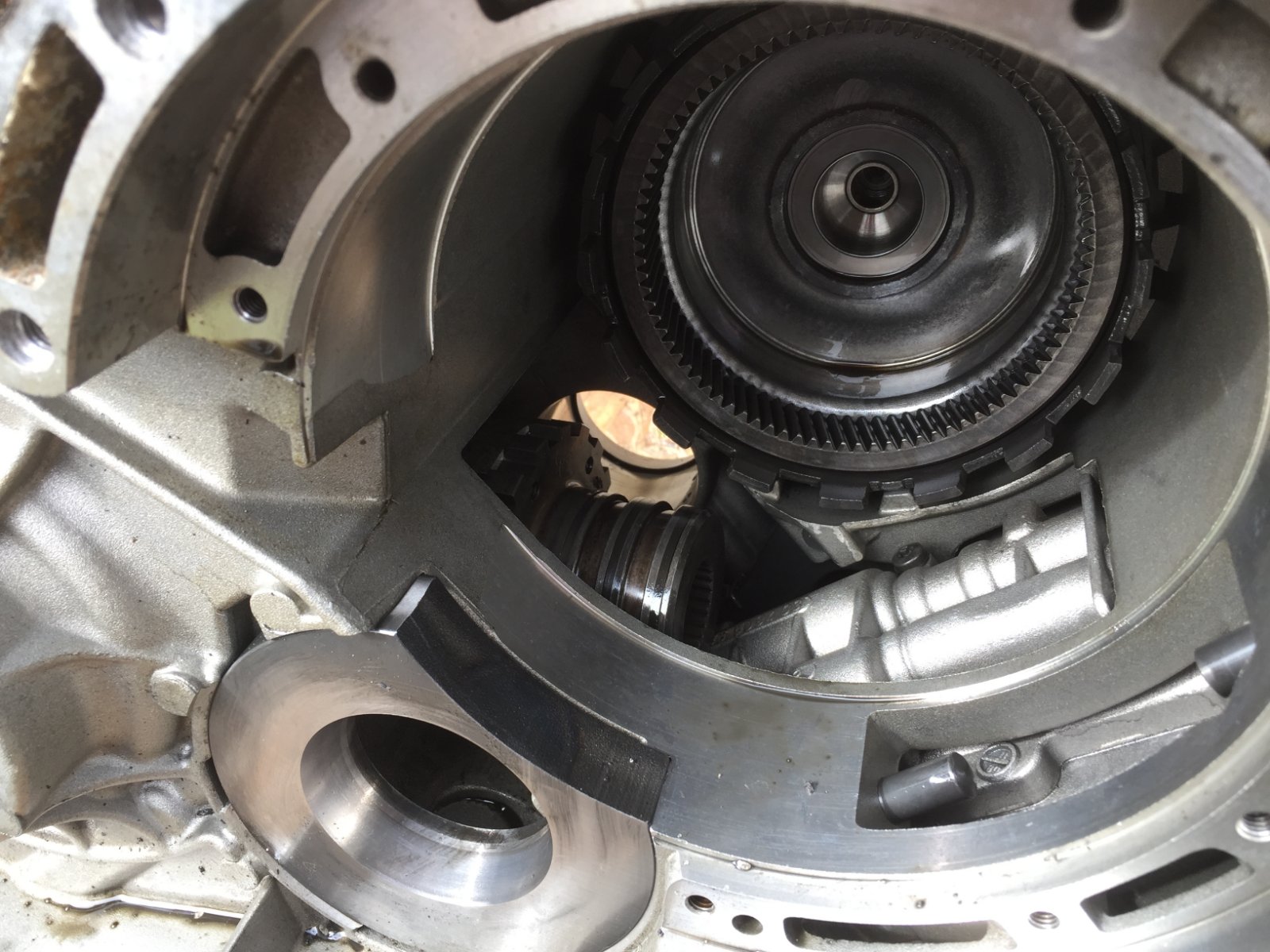

Today I pulled most of the gearbox apart, just to see how it works. I didn't remove the hydraulic block or sump, but I believe that I have a few answers on this gearbox.
And of course, I got some pictures of the insides.
This is the most interesting picture. It shows the planetary gear carrier at the top. I couldn't get this out because it has a small allen key nut on the back and I don't have one strong enough to undo it. I think there's a one way clutch behind it too, which must be jammed because the outer castled gear carrier wouldn't turn alone or on the centre shaft when the planetary gears were inserted (which is essentially 3rd gear). It was just jammed solid, which would explain why the gearbox locked up when trying to change gear. The inner cog span freely, which is (indirectly) connected to the output shaft.
Also in this picture is the before mentioned regulator, in the bottom of the gearbox. It is shown sidewards here, showing the sealing rings. I think one of these has failed too, as it is too small to fill the hole. There are 3 in total, 2 rubber and one metal, and if this is the case, then it's why it completely lost drive (although why it happened at the same time as the other failure must be coincidence). The machined groves on the regulator are the gearbox park locking mechanism. The regulator wouldn't come out of the gearbox because there wasn't enough room with that cog still inside.
Here are the planetary gears themselves There are actually 8 cogs in here, 4 for drive & 4 more for reverse. It uses 7 of the 8 the gears for reverse so it sends the power the opposite way.
This picture is blurry as the camera had oil on it & I didn't realize at the time.
These 3 cogs sit straight on top of the planetary gears. The outer most one is reverse & the centre cog is 1st. I couldn't experiment further as the inner most cog wouldn't turn.
Edit: I have done some more reading up on how they work, and I think that I've worked out what all the combinations are. There is another clutch pack in the back of the gearbox that I initially missed, although it can just about be seen in the 1st picture. I'm now not sure if it has a one way clutch too or if it's just that clutch pack with something seized in it.
The combinations are: (as shown in the picture above).
1st: is driven off the centre cog with the back clutch locked
2nd: is driven off the centre cog, as with 1st, but the outer most cog used for reverse is also used.
3rd: is driven off the centre cog too, but it also uses the inner most one too.
4th: is driven off the inner most cog & the outer most one.
Reverse: is driven off the outer most cog with the back clutch locked.
As 1st and reverse need the back clutch locked to work, that's why it would initially work in these 2 gears, but the car stood on its nose when it tried to change into 2nd gear (before it lost drive completely).
Here are all the clutch packs, the input shafts, the oil pump & the brake band. The cog on the left also has a one way clutch in the front of it. It sits right behind the oil pump with the brake band around it. The input shafts (shown on the right with the clutch packs) go behind it & the oil pump goes at the front. The oil pump itself actually drives reverse when the clutch pack is engaged.
I didn't get any pictures of the other side of the gearbox or of the output shaft, but it only has 2 cogs on the back, & the output shaft just connects directly from one of these said cogs, through the regulator and onto the diff.
Interestingly, I was expecting lots of parts to be broken inside this gearbox, but there wasn't. The cogs were clean, there was no real wear on them; one shown on youtube was completely chewed up. The clutch packs are all in good condition & the brake band is unworn, which is surprising considering it's done 199250 miles. The only things that seem broken are that worn ring on the regulator, an apparently seized one way clutch in the back & the seized oil pump (which must have seized from standing, as it wasn't seized when the gearbox was removed).

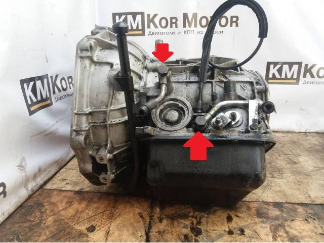

Nice!
Can you take some pics on that area:
Top: PSA box
Bottom: I think it is from a Daewoo Nubira
Because i'm thinking if installing hoses on that parts pointed on bottom pic, in the PSA box, maybe the water cooler could be removed and instead, use an external radiator? For hot weather countries would be a good improvement if it could be done.
TIA

The actual case of the gearbox is slightly different between the two pictures. Underneath the oil cooler there are two oil ports; one for letting the oil in & another for letting it back into the gearbox. The only way I could see of putting an external radiator in it would be to somehow modify the ports to pipe the oil up for the radiator or have the internals of the oil cooler removed and/ or modified so that the oil could get out of the (water) pipe ports, in which case you could then pipe it to an oil radiator that way, but I can't see it being very efficient, unless you had it engineered so that the oil could only get through one way. I did take the oil cooler off to have a look behind it, but I didn't get a picture. It just looks the same as behind the engine oil filter looks when it's removed. If I remember, I will pull it off again and get a picture of what's behind it.Slagtrooper wrote: ↑Wed Jul 15, 2020 3:25 am Nice!
Top: PSA box
TIA
