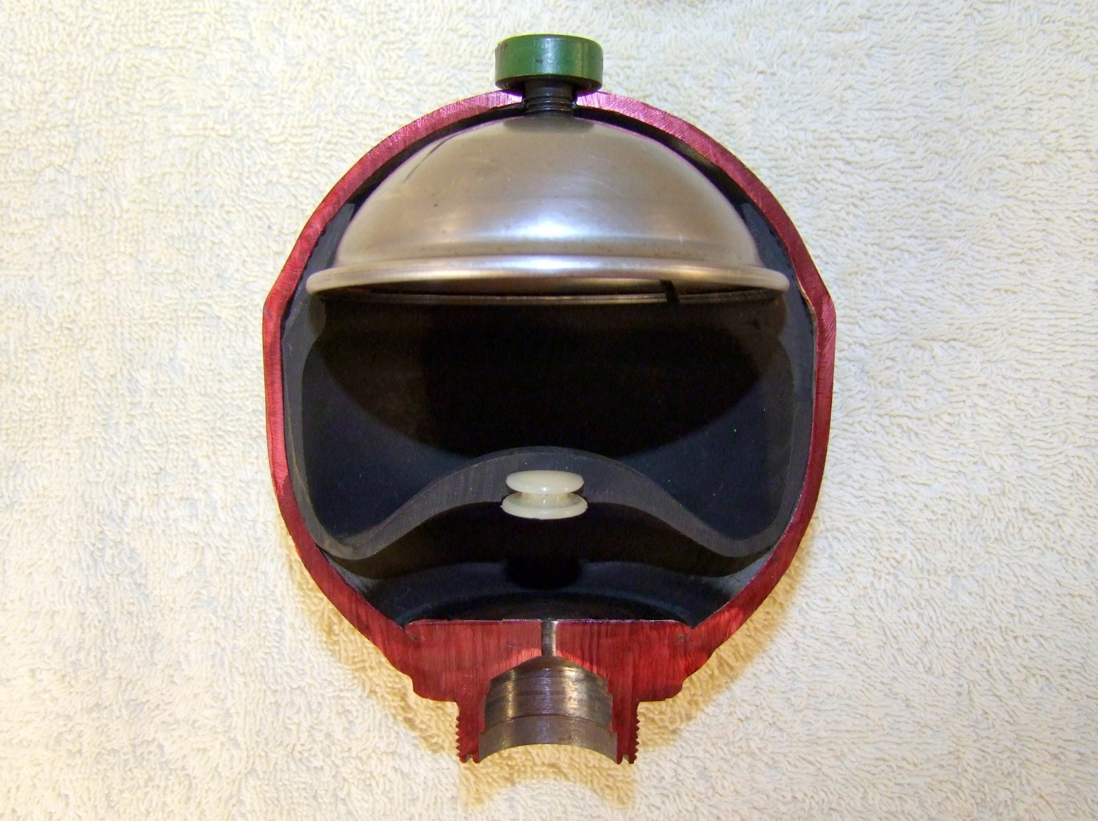

What finishes spheres off (apart from extreme old age) is driving the car with very low gas pressure. This forces the membrane upwards, against the internal pressed-steel dome that holds the diaphragm in place. Some of the aftermarket spheres have less-than-smooth edges on the perforations in this plate, and this can damage the diaphragm. (Genuine Citroen spheres have rolled-back edges to these perforations, and the problem is avoided.)
In normal use, at correct pressures, the diaphragm will never touch this metal dome, and neither will it be asked to flex upwards by that amount. It's usually reckoned that if a sphere's gas pressure has dropped much below 15 bar, it ought to be ditched, rather than re-gassed.
Driving on flat or nearly flat spheres is what countless BX and Xantia owners did out here in Spain (and probably elsewhere too), too mean or too ignorant of the need to maintain this type of suspension. The result was a bumpy ride ("not the ride it used to be...") and - in countless Xantia (and XM) cases - sheared front strut tops and speared bonnets.
Not sure about that recommendation of leaving the pressure (presumably the gas?) released. OK for spheres stored off the car, but not a good idea on the car, if it were to be started and raised. Maybe I misunderstood.
If good quality spheres are used, and kept at proper pressures, their life can be extremely long. Being able to check the gas pressure (as well as top it up) is what makes the re-gas kit so attractive - especially now that the cost of the tool has reduced. For anyone running more than one fluid Citroen, it's a really good investment.
