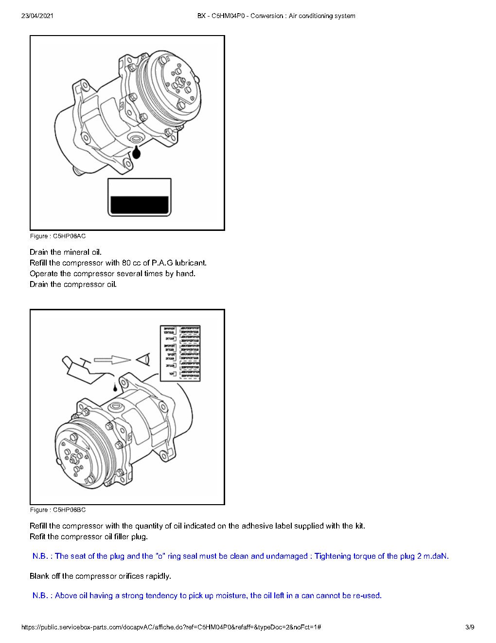

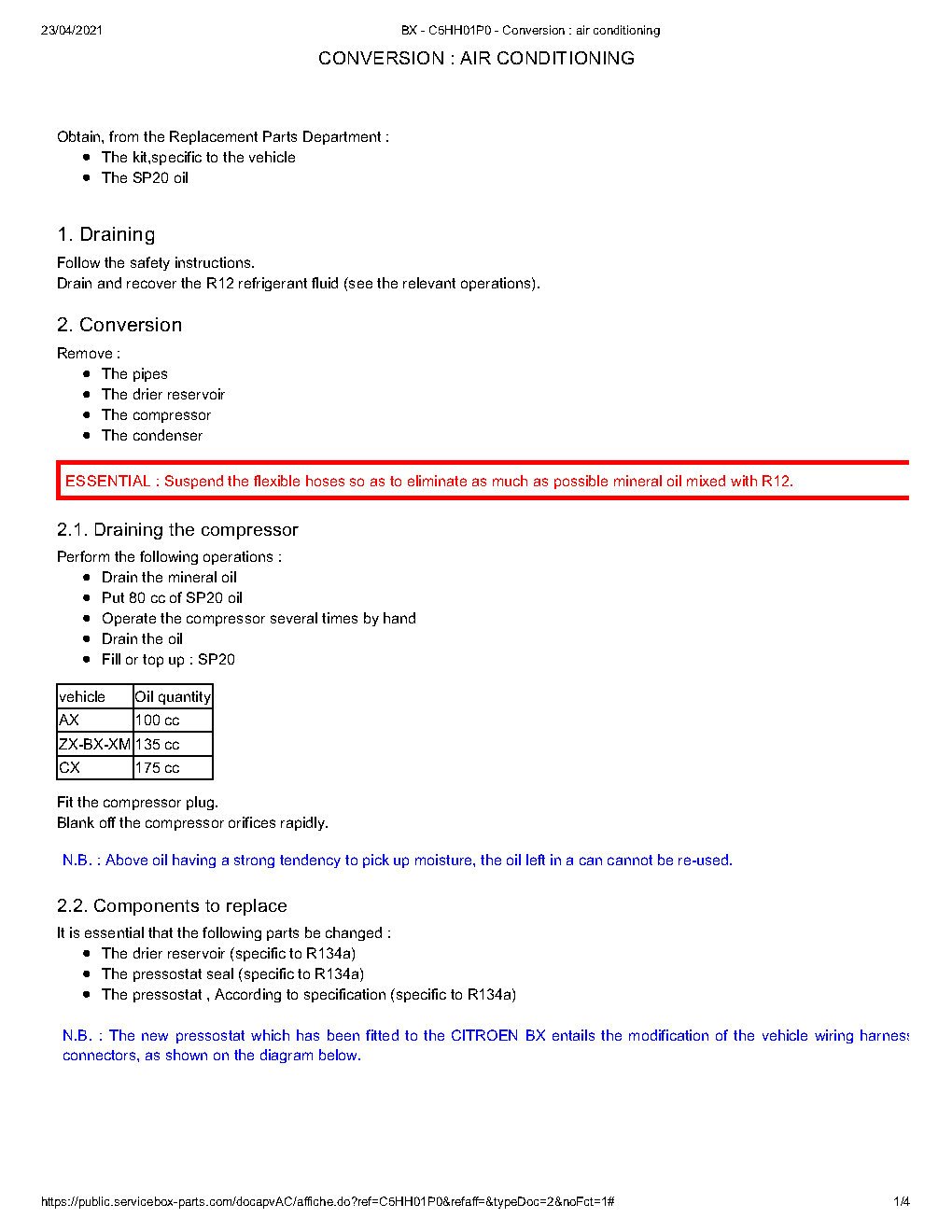

...and some Citroen R12 to R134A conversion instructions for the BX:

You'll then need to convert it to R134A. Again this has been covered in great detail on this forum. I had problems with my original compressor, and in the end I fitted a new one from a Lamborghini Diablo, which was already converted & fitted perfectly on my BX.
Make sure that you replace the dryer & all the O rings before you try to get it re-commissioned.
