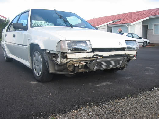

Like you i'd quite like front mounted cooler so you'll have let us know how you route the piping and where it's mounted under the bumper. i'm sure i saw a 16 TGi in a aldershot car spares some years ago as i got it's chrome bumper strips for my old dtr turbo.

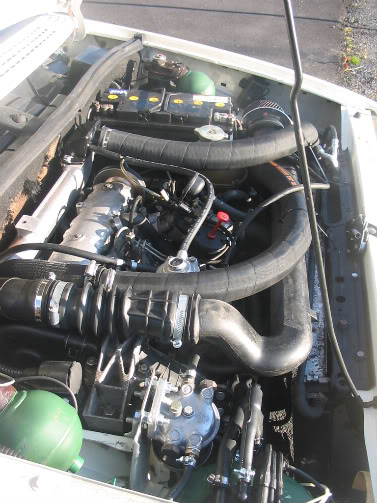

Current.

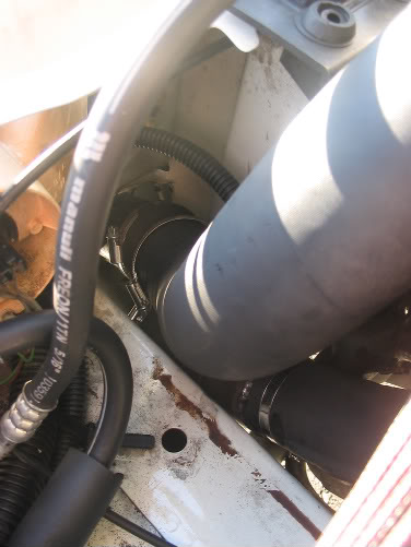

that's looks good nice and clean. what size piping did you use? and did you have to modify the inlet manifold?
Current.
You can buy an adapter from Club-306 forum.
http://www.club-306.com
There's an sale thread for FMIC adapters. You need to register to see it.
Don't remember pipe size..
If you mean what I think you mean...
...the bit that goes in here...
You could be in for a long wait. I took mine off while spraying the bumper (when all but one of the bolts sheered) but they are back on now. I don't think you can buy them separate from the bumper (I may be wrong).
Your best possible bet would be to find someone with a spare bumper who will either let you have those bits off it, or possibly make a copy of them to use.
Sorry I can't be of any more help.
