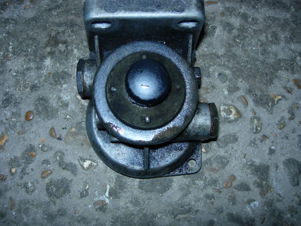

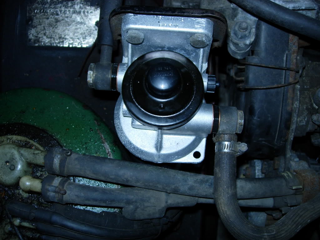

As long as the input and output pipes are the same as your original one then it might. Sophie's were of 2 different sizes. Also, you have to make sure the filter cover attaches itself to the primer head the same way as your original.If any of these things are wrong then it wont work. Ime told the one off a diesel Ford Escort will work, but you will need the pipe attachments that go with it to attach to your existing fuel pipes so that these can be screwed onto the unit.
First piccy is the original top, 2nd, the replacement. Looking at the one you have found, i can now see it wont do. I got mine from a local motor factor who took quite a while to get it. Did see one one feebay a few weeks ago, went for about 23 quid i seem to remember.
