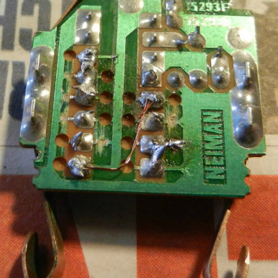

Mat, I have a second plip that I need to recode to my current plip/receiver set up, could I just take my current plip apart and recode the second one by matching the connections on the rear ? thus making two plips work with one receiver ?

Yes, you can do that - as you already have a working one there's no need to work out the reverse logic above. Just don't do what I'd probably do and match the existing one to the non working one... :oops:

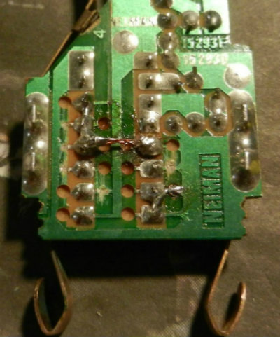

After much effing and blinding in the early hour of the morning I now have two plips for one receiver :D :D I gave up trying to connect each terminal to the High/Low with their own connection and ended up soldering them to other terminals which had proper connections
As you can see, terminals 2 and 3 have been soldered to terminal 1 which is Low, and 8 has been soldered to 7 which is High, I soldered terminal 10 to terminal 3 for the Low connection it needed.
But I found when putting the plip back together that there is a plastic blade that runs down the middle of the terminals so I've had to re-route terminal 10 to terminal 6 and made sure that the copper wire doesn't short out terminal 9
Sorry for the size of the images, I've tried shrinking them on photobucket but it's not playing ball :evil: Anyway thanks for the help Mat

TizzyD wrote:But I found when putting the plip back together that there is a plastic blade that runs down the middle of the terminals so I've had to re-route terminal 10 to terminal 6 and made sure that the copper wire doesn't short out terminal 9
Yeah, sorry - that's what I meant when I said there's more space in the receiver casing - should have elaborated on that. Glad you got it working although I'd be careful with the wire running near terminal 9; maybe a dab of glue to hold it in place and insulate it?

A bit of glue would be ideal but I don't have a glue gun so for the time being what I've done is put the plip back together and move the wire into a different position which should be ok for a while
